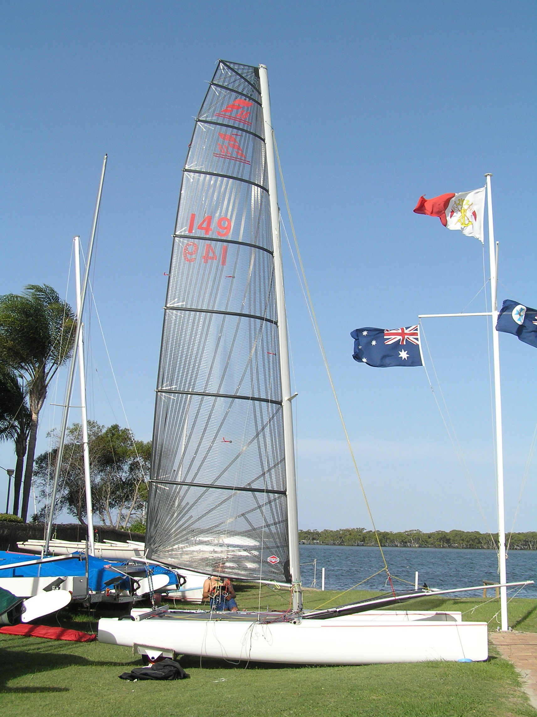

Ben,
I really like the appearance of your F16 mainsail. I was hoping to get something like that when I ordered a modified F16 main back in 2003. But I got one with the characteristic Taipan leech round despite the fact that my square-top is 580 mm.
Anyways, I think it is very good that you still got the same foot length as well. With this sail the Taipan looks alot more modern again. I really like it; looks sharp indeed.

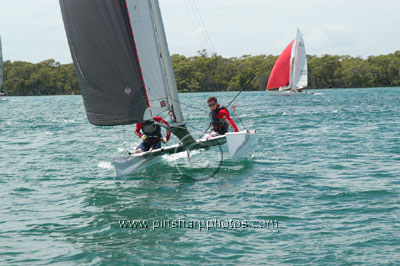

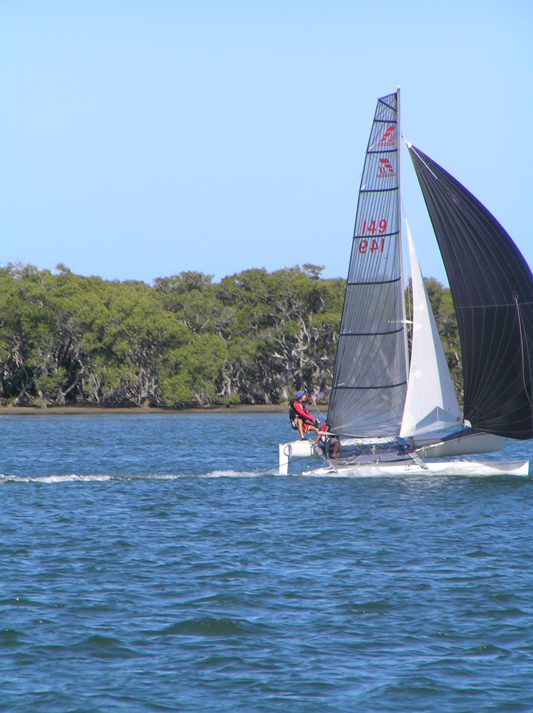

Also a twichy sail is no good, best is a compromise between speed and ease of trim (forgiveness). I hear AHPC went for 840 mm head and that seems like a lot !
I am pleased with the user friendly leech of my new sail, the mast looks as steady as a rock up-hill unlike downwind!
What is your combined crewweight ? Our fears are that the rig will depower to soon with a head that is too large. This can be corrected by moving the hounds up a little but we need to know how much this is needed. If it is alright as it is than that would be be especially great. I'm hoping that increasing the mast rotation just a little will be enough to bring the top back in again; resulting in only increased performance and no need to modify the mast design.
And , what about that top on downwinders ehhh ! We got a scare as well but the mast just took the beating as if it was fully designed to do. When I ran to little leech tension on spi I was told by other sailors that the mast flexed forward by 20 to 30 degrees. But it survived just fine and it is still straight ! But I run a little more mainsheet tension now, when fully powered up under spi.

Hi Ben,
welcome, love the look of that main. Must have been fun putting all that carbon tape on it.
