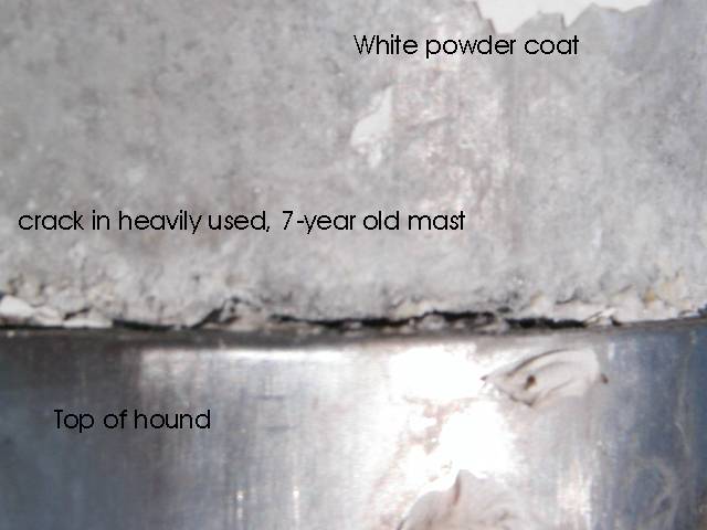

Maybe the next thing in beach cats will be a second set of diamond wires and spreaders, just like big boats.
I do agree that we may see masts which are diamond wire supported for their entire length. Adding a new set to the top is a likely way to experiment.

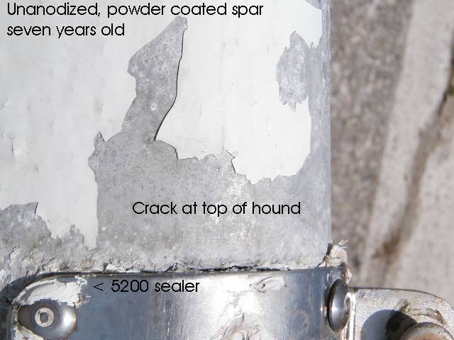

Photos of my mast crack are attached. As you can see, I was a lucky guy when I caught the problem just before emminant terminal failure.
You are so right about the disimilar metals and the rivets. But I must also contribute the failure to the straight horrizontal line shape of the top of the hound and the fact that the mast above this point is in almost constant motion during most sailing. Each tack reverses the bend and each bump or puff causes some pumping.
See third and forth pictures in subsequent posts.

Upon looking at the failure, I am convinced that the heavy corrosion of the mast tube in the vacinity of the masthead played a key role in weakening the tube. It does so in three ways. The first way is obvious: corrosion erodes some of the metal away leaving it thinner and therefore weaker. The second way is that the corrosion always eats a very jagged, irregular path through the metal. This acts the same as a deep scratch or hole causing stress concentration. The third way is that it causes chemical/molecular changes to the metal making it weaker and brittle.
It might be a good idea on these painted masts to remove the masthead and fabricate a barrier gasket out of something and re-install. This would stop the galvanic action for good. A piece of mica is a good candidate.
I am not a fan of painted aluminum parts on boats. Anodizing holds up much better and stops galvanic corrosion much more effectively than the typical conversion coating used to prepare the mast for paint or powdercoat.
You really must not tolerate corrosion on the aluminum parts of your boat. If you start to see any corrosion, it must be dealt with by dressing out and applying conversion coating and re-painting. I'm a bit worried about the mast and beams on my old P19 and it's maybe about 1/100 as advanced as the corrosion I see in the pics.

That is not a stress crack but is a crack that developed through galvanic corrosion. This corrosion is caused by minute electrical currents setup by two disimilar metals that rob the 'anode' material of stucture at the molecular level...the aluminum in this case. It surprises me that I haven't seen any manufacturer put magnesium anodes on our aluminum parts. My monohull has anodes on it's mast as do most power boat motors and such.

Cracks always happen when the metal is under cyclic stress, but in this case the metal was weakened and perhaps embrittled by the galvannic corrosion. So which was it, stress or corrosion? The point is that you just can't tolerate corrosion on your boat! These boats don't have a lot of safety margins engineered into them. If they did, they would be thicker, stronger, heavier and slower, and we know we don't want that! So you just have to stay on top of stuff like this.
The anode is a gret idea, BTW. I think zinc is the standard metal used for this purpose and you can buy zinc anodes at any marine store. One for the mast and one for each beam. Sounds like a plan, especially for these boats with painted masts and beams. Adds a few ounces weight at most.

Yup--Corrosion at horizontal joint of dissimilar metals covered with crappy looking old powder coat on non-anodized mast! No surprise to me.
In 30 years I've NEVER seen a anodized (Hobie or Nacra) mast break like this. Their holes wallow out where stainless steel pop-rivets are wet with salt water, tho.
Also many extrusions are thicker on the side walls.

Why does the anode get all the attention?? Galvanic corrosion requires several things to occur. An anode, a cathode, an electrolyte and a conductive path.
In addition to maintaining a coating on the anodic mast, it would also be beneficial to paint the cathodic SS hound. More beneficial, in fact, because another variable in how quickly the anode corrodes is the surface area ratio between the cathode and the anode. A scratch in the protective coating on the mast near a large uncoated cathode will produce more concentrated corrosion than if the mast were unprotected.
The conductive path. If the hound was bedded with a dielectric sealant and the rivets installed coated with the same, it would minimize (in addition to what you've achieved with the paint) the conduction portion of the circuit. The RTV would also minimize the electrolyte getting into the joint. I don't know the dielectric properties of the RTV sealants readily available at auto and hardware stores.
The electrolyte. In this situation with the mast-hound joint, it's a very small circuit. Since the mast is out of the water the majority of the time, the circuit will be that small crack in the joint were dew or rain can collect and work with the salt that has collected there. A dielectric RTV filet could prevent that from happening. I think that this mechanism would also negate the usefulness of a zinc sacrificial anode because the sacrificial anode has to be part of the circuit. In this case, attaching a zinc to the mast won't prevent the galvanic corrosion since it doesn't share the same electrolyte path for the ions that the mast-hound circuit does. However, the zinc anode would protect the mast while the boat is turtled.

That mast looks like classic galvanic corrosion to me.
The base metal almost always corrodes from the inside and then the cracks become visible from the outside.
I have seen crossbars break at the location of pop rivets.
