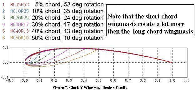

Refer to this thread linked below and this image that was posted by Luiz. It's all about creating an efficiently shaped airfoil.
Rotation Thread

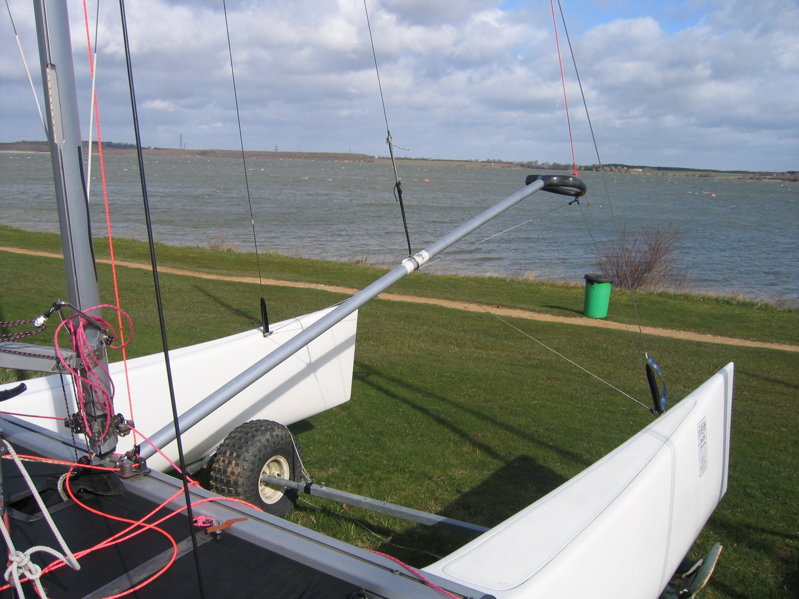

I have sail number 35. That would make the boat 5 years old?
I have included a picture to show you what lines I am asking about, the yellow lines.
Your boat looks great!
Matrijn

The Taipan often runs with less rotation than other boats. The tips giving in the taipan tuning guide are good but you may want to increase the rotation a little beyond what is stated there on your boat. Note that the two boats are using different mast sections; the crosssection of both is noticeable different with the I-17 being teardrop shaped and the Taipan mast being oval shape. The Taipan mast is much thinner (63 mm to about 90 mm on nacra masts).
