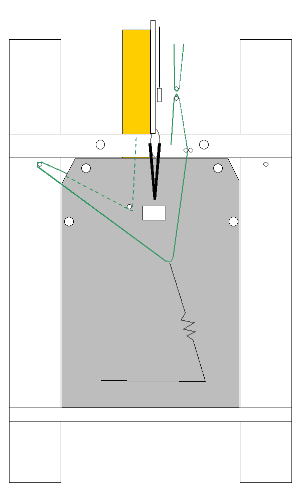

Welcome to the class Bill,
I may have a slightly different answer to your questions then you initially are looking for but my experiences are that you can best totally seperate the spi uphaul (halyard / retrieval line).
I used to lead my spi halyard line (lets keep calling it that from now on) all the way back on my trampoline but never got it too work as I wished.
I still sheet the mainsail of the back beam but I'm going to add a twist to that. The biggest improvement was made by removing the spi halyard from the rear halve of the trampoline all together.
See the drawing :
I now lead the retrieval line that comes out of the snuffer system to a small block that is attached on the underside of the trampoline and right to the rear of the snuffer sock. A line from the block to the rearbeam (also underneath the tramp) keeps the block securely at its place when under load. The retrieval line itself comes out of the snuffer sock and runs through this little block to right behind the port end of my mainbeam near the inner gunwhale of my port hull. Here my trampoline comes clear of the hull and a small gap is present between the hull and the trampoline. On the rear of my mainbeam and above the middle of the decks I have fitted a small block to my mainbeam, (free to rotate and angle to all directions) . The retrieval line also runs through this block and than angles back, and running on top of the trampoline, to a free hanging ring (or block) before angling forward again to my spi halyard cleat on the starboard mainbeam (near the mast). The freehanging ring (or block) is attached to a bungee cord to keep the retrieval line tight and prevent it from tangling.
Not how this system never lets the retrieval line/ spi halyard to ever pass beyond the forward halve of the trampoline and it also allows you to pull on the retrieval line while facing forward. Especially the last is very handy while singlehanding. You can also retrieve the spinnaker from nearly anywhere on the trampoline, this includes the luff hull of the time (both of them) which in big winds is big nice-to-have. By leading the line through the gap and angle it from underneath the tramp to above it, the system has very little friction, less than when pulling through an large eye in the trampoline. This is another advantage. Also the chance of you sitting on the line whil hoisting or retrieving is alot smaller than when leading the line all the way back the rearbeam. This is also a great advantage. You are noticeably less like to foil up.
I'm found this setup to work the best. Give it a try
