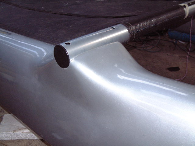

Hi Magnus,
go for it, metallic silver is a great colour for a F16 (or any fast boat !!
My boat is about 2 years overdue for a new spraypaint, if you`re handy with a spraygun you can do mine too.
Steve
59254-pic 134.jpg (85 downloads)
