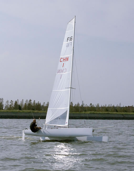

Here is Dirk with his Landenberger mainsail.

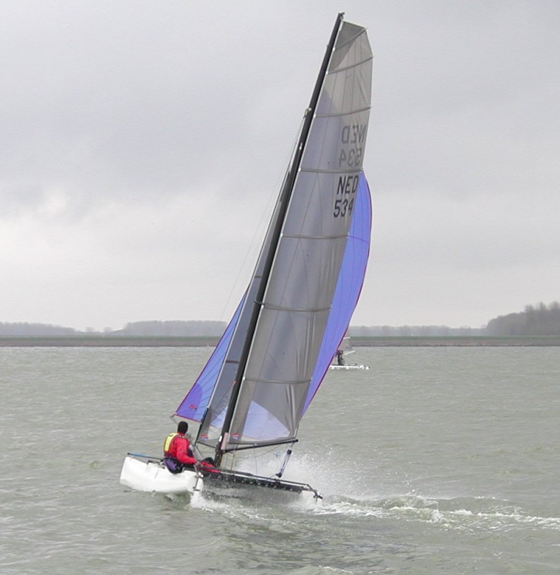

Here Bart and myself running with a full suit of Landenberger sails on a Stealth F16

What's up with the wrinkles showing in both sails above? Not enough batten tension?
I'd say probably not enough luff tension (or to much main)
although the battens in the cat rigged one appear to be almost "S" bending? which could indicate (among other things) that the battens on that one, at least, are not heavy enough?

I notice there's quite a difference in shape between those mains - the white main with more of a square top. Do you know which of these they're making as F16? Or are they offering a choice?

he did not made any F16 sails for the taipan superwingmast before I approached him, but has a 4.9 standing at his loft and could take all measures again. the sail you see on the picture is basically a current A-class sail shape adapted to the lenght and characteristics of the aluminium superwing section. I asked for this extreme square top and I am really happy with it.
as designed for singlehanded sailing it's nicely flat but I also sailed it with a standard 4.9 jib doublehanded against a standard 4.9 with a new standard 4.9 ashby sail and even in light winds (where I expected a weakness) I seemed to be pointing higher with simular speed... but if doublehanded sailing is your main target, you should definitely ask for a fuller sail!

the wrinkles in my pic are probably a combination of to less batten tension and to much mainsheettension while cunningham not yet pulled at all. looks strange but actually was fast
in the other picture I believe they sail with a full rotated mast and the narrow sheeted jib is putting pressure into the main from the wrong side. situation could be improved by less jib tension and less traveller for the main, maybe more mainsheettension and surely less rotation.
at least the taipan superwing section is a very strong profile and don't need to be 90° rotated just to protect the masttop from breaking... luckily its not an aluminium tornado mast... I use (surely class illegal but we have no F16 sailing here yet) F18 spinnaker, so I hoist the spi till about 50 cm below the masttop and that is a point you start to worry about your masttop and full supply from the main is really needed...
