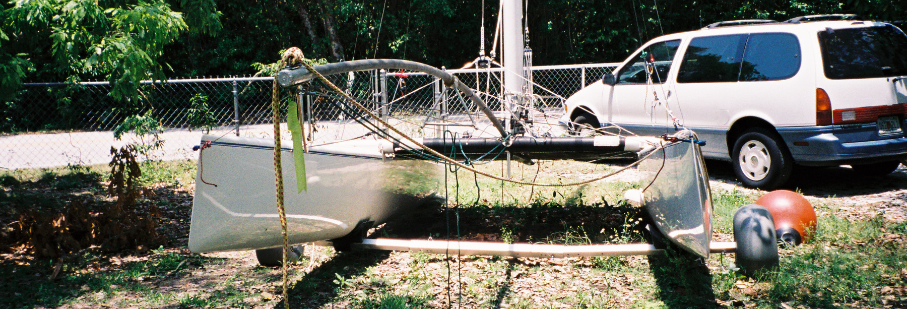

The Taipan 5.7 has canted hulls. The general consensus of those who have sailed them extensivelly is that there is little, if any at all improvement. Even one of the Taipan designers, Jim Boyer, said that he preferred the 5.7 without the canted hulls. Attached is a bow photo of the 5.7. You can clearly see the outward canting.
Lance
Taipan 5.7 USA 182

I'm not so sure of the canted hulls as I am certain that your Taipan 5.7 has Peyronie's Disease. Tough break for you...
