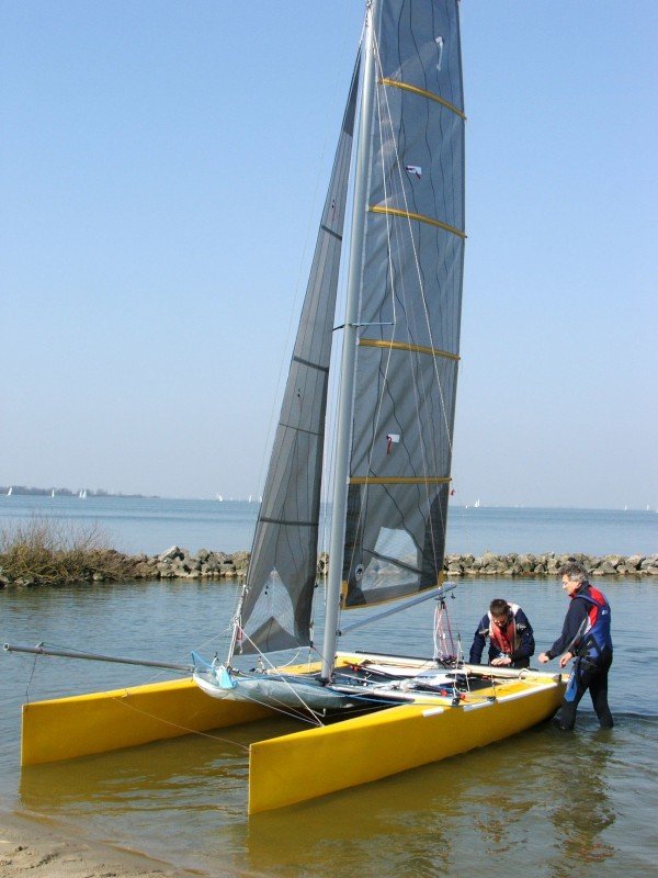

I reach this conclusion buy looking at the data I know about the Taipan design. I've also quickly remeasured my jib for you, read on. My halyard block for the jib is on a little pigtale that is 150 mm long. The pigtale is actually just the forestay wire that has been run through the thimble (eye) that takes the hound shackle and that has not been cut of near the thimble but has been allowed run down and end in it own thimble.
Pretty much the hound fitting if 6050 mm above the mainbeam (mast 6000 mm mast foot being 45 mm and base section being 5 mm high)
The bridle fittings on a Taipan are at least 1.30 mtr. in front of the mainbeam. This makes for a 6188 mm distance between the hound fitting and the virtual horizontal line connecting the bridle fittings if the mast is prefectly straight up, which it really isn't (there is noticeable rake there). This length is taken up by about 650 mm of the bridle strop (Bridle triangle) leaving still at least some 5538 mm for the forestay length itself. On my boat the top of the mainbeam is about 65 mm higher then the bridle fitting tops. But indeed my mainbeam was raised by 25 mm relative to the standard Taipan. But still this will add about 40 mm to the forestay length, making it (on the Standard Taipan) 5580 mm if the mast is straight up. By raking the mast back by 700 mm (pretty normal for a Taipan) you gain another 100 mm on the forestay, arriving at 5680 mm in total between bridle strop and hound fitting. My pole sits 350 mm below the bridle strop leaving only 5480 - 350 mm = 5130 of the jib to sit on the forestay allowing some 5680-5130 = 550 mm = say 500 mm distance between the hound fitting and the top of the jib.
And that is exactly how it looks on the pics of my boat. I will post a couple of them. Please note that my bridle strop is actually at 700 mm up from the bridle fitting on the hull. I increased the strop height as my boat is wider than the standard Taipan 4.9 and I wanted to maintain the garanteed angle of the bridle force on my bows.
I've taken out my jib from its bag layed it out flat in my room and quickly remeasured it. Note that the data given earlier was all measured when the luff was pulled very tight to take all wrinkles and stretch out. The quick remeasuring came out at 5430 mm. 50 mm shorter then when measured with a good deal of tension on the luff. The luff was fully untensioned this time. I'm absolutely convinced that I can pull the addition 50 mm out of it with some normal tension. Note that this is the exact same jib as shown in the pics below.
Especially when looking at the pic on the bottom it is quite clear how much margin there still is near the hound fitting. Either I'm making a huge blunder somewhere or the Taipan fore triangle with spi pole strut will take 5500 mm luff, 3.5 sq. mtr. selftacking jib.
I would venture to suggest that you check your measurements. Somewhere there is a mistake, will be interesting to find out where.
Here as I was using it in april 2004 : relatively high on the forestay, see the space between foot and spi pole
Here as I'm using it right now (and during 2005), tack corner is much closer to the spi pole. It is actually almost right on it but I've already detached it here so the wind is blowing the tack back and away from the spi pole

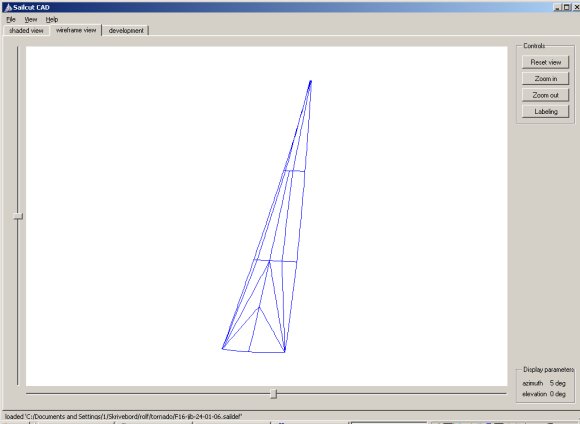

Just for fun, I entered the measurements Wouter gave into Sailcut, scaled down the luff curve from our Tornado jib and gave it a 10% draft. Sailcut calculated surface area to be 3.32m2. The file is available for download if you want to play with it.
http://www.tornado-norge.org/sails/F16-jib-24-01-06.saildef
http://www.tornado-norge.org/sails/F16-jib-24-01-06.dxf
