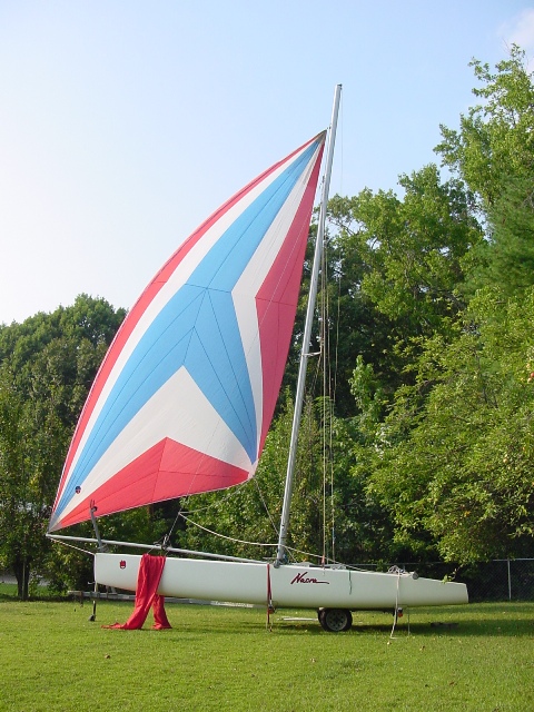

I am getting ready to do a spinnaker for my NACRA 5.8, and would like to know where I should drill the hole (s) in the bow for the “stay lines?”
My current plan is to go with a 3/8th inch hole with a piece of SS tubing epoxied in to prevent wear. Also, I am thinking of using “am steel” line for the stay lines, any other recommendations?

I would have done this a bit simpler and drilled a 1" hole. Tape one side and fill well with thickened epoxy, making sure you get a solid fill inside the hull to bind to the hull/deck and spread loads. When dry, I would do a smaller hole in the thickened epoxy for the line. Regular 5mm dynema/spectra will do nicely, and I would be more concerned about wear on the line than on the epoxy.
This is the way our Tornado is done, and it works very well.

When I put the spin on my Nacra 6.0, I just installed an eye bolt (3/8" diameter?) about 1.5" back from the bow, about 1" down from the deck. The glass is really thick here, and will handle the load fine. I put a rubber gasketed washer on each side of the hull where the bolt went through, and made sure to use 5200 around the hole to prevent leaks. I never had any trouble. I would recommend New England Ropes- Endura 12 line in 1/8" for the spin bridles. I have used it, and it is great. I can splice it if you'd like as well (no knots!), or you can just use a bowline. There is no need to use a purchase on the line, as a single one will be more than ample for the load. PM me if you want more info.

How about drilling no holes in the hull? The Tiger uses the same area that the bridle wire goes. It seems to be a very strong area as it is really designed to take a lot of load.
Line - Think about using Vectron instead of Amsteel. I think that Amsteel is Spectra. It is a really good choice after it is stretched but the Vectron will stretch way less. I use Vectron for that application and like it.

The problem with doing that on the 6.0NA is that the pole is already SOOO low because of the bow foil that if you run the wires all the way back to the bridle tangs that they're at a rediculous angle. They really must go to the bow on the 6.0NA.
I never had my kite out in extreme conditions - but my bow foil was at standard height and my pole was unsupported except by the end pole bridle wires and being lashed to the bow foil...although it had a rather large cross section. However, most of the 6.0NE (New England) guys that converted their boats to spinnakers DID extend their bridle foil wires several inches and ran diamond wire trusses on their spinnaker poles to give them additional support.
