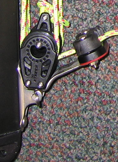

on the harken 6:1 downhaul for the hobie 16, what is the bottom block attached to?
I had been considering using two single blocks I have laying around to make a downhaul on my boat so it would be easier to pull down, at least till i can afford to buy a 6:1

The Hobie brand downhaul kit comes with some sort of a bracket that can be inserted in the extruded slot in the mast (goes in before the boom is inserted in the same slot). I have a home made 4:1 nock off that uses a similar bracket to hold a violine block in the same place. I think I made this thing before the block style downhaul became class legal.

The bracket is the same as the top piece of the main traveller car.

Matt, you're pic did'nt work. Will an eyestrap, secured with two track nuts and screws, work as well?

The eyestrap may not have enough clearance - you would have to use a twist shackle to attach the lower block, or re-reeve the line every time you took the sails off the boat.
I bought a couple of the traveller top plates from the "used parts bin" of my local dealer for $5 each.
Got the photo to work this time . . .

how did you get that to stay down, do you use a couple screws with nuts inside the track like the cleat that would normally be there?
and where did you get the peice to attach that cleat or is that part of the block?

Is part of the block. #10-32 nuts to fit mast track at catsailor store as well.

I don't use either (bullet or carbo). Harken Micro Blocks.
It's important to use square (not hex) nuts to secure the bracket. They will grip the inside of the track, whereas the hex nuts don't.
Even so, I still had a problem with the bracket working up the mast. Used a file to make a flat spot for it (and create a bit of a "ledge" at the top) fixed that problem.
The upper end uses an old tiller extension connector/bolt to replace the ring/pin that holds the gooseneck together. Otherwise, you'll shear the cotter pin right off.
