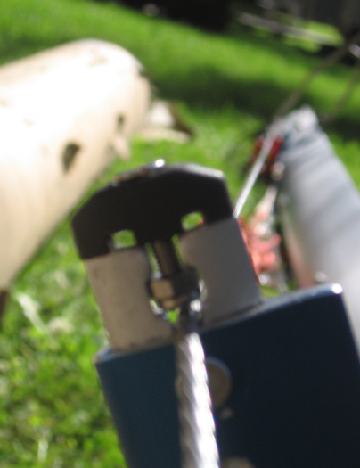

My first exposure to pre-bend masts. I decided that the diamond wire belongs in this part of the spreader. (Apologies for the poor focus).
When I go to tighten down the cap, the screw starts binding on the wire before the plastic cap sits down snug. Do I take 3 mm off the screw? Or is the wire meant to be in the caps notches?

No you didn't do this right.
Take it apart and use the notches. Well, just one of them obviously. To be exact my spreader (same brand but 3 years older then yours) has only 1 notches and that is all you need. So partly I don't understand why yours has two.
Best is to tighten the diamond wires first and then pull them onto the ends of the arms. There should be small corner or ver shallow notch at the very end of the silver coloured part of the arm. The silver coloured part is the slider that allows a sailor to adjusts the length of the spreaderarm. In your case your want the arm at minimal length, it looks like you've done that.
You can tighten the diamond wires ones they're on the spreader arms but your risk cold welding of the nuts to the threading and pulling the threading of either the nutts or the terminals. This last issue seems to be less frequent these days, maybe the threading has been improved on the terminals/nutts. The first issue can best be solved by (properly) greasing up the threads before assembling. An extra safeguard is, as mentioned, not tightening the wires when they are in the spreader arms or at least minimize that action.

I took a picture of mine - as far as I know you can put it on either notch. It doesn't seem like it is very stable, but mine have never slipped off. The first pic I unscrewed the cap some so you could see where I position the wire.

Actually, mine came from the factory this way. I had it all apart and, fortunately, remembered how it went back together.

I started off the "right" way but as things got tighter I had the easy one jump into the deeper groove while pulling the hard one on. So I said to myself, Hmmm. It just seemed like the little ear on the plastic cap wasn't substantial enough. But that is why I asked.
After setting the diamonds to the default values I was given for prebend and rake, I ended up with a tension of 39 on the Loos Pro 1 gauge. (And about an inch of the stud sticking down below the base plate.) I did have a couple millimeter bend to the right but I guess I'm adjusting everything a bit more anywise.
The two holes are different sized. 1/8" and 3/32 or something. Thank you for your quick replies and photo's.

At first, I thought I had two options, but really the notch at the rear is the only feasible option as the wire will stay in this position without the caps. The front notch would require the caps to hold it in place, making it more difficult to adjust and putting sideways force on the plastic caps. You can spin the caps to fit 3mm or 2.5mm cable.
While adjusting the cables, I found it quite easy to just lay the mast on the grass, and while sitting, push against the mast with my feet holding onto the wire. And just leave the caps off while making the adjustments.
