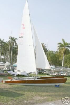

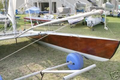

Re: Tornado Question [Re: Twister] #78855
06/29/06 01:22 PM
06/29/06 01:22 PM
Posts: 126
southern Ontario
Twister Offline OP
Twister  Offline OP
Posts: 126
southern Ontario
The boat is a 1997 Wood/Carbon Composite Tornado Built from the original Houlton International Tornado class plans using West System Epoxy with the following modifications:
Bridle wire attachment changed to bulkhead for added strength.Enlarged tramp lacing eyes.Interior layup was changed from Glass to Carbon Fiber.Decks changed from Plywood/Glass to Balsa Core carbon/Kevlar composite to increase stiffness.
The boat will not be class legal and therefore holds little value and is being sold for a song. I thought it might nice to pick it up real cheep and put on a second trap and chute (either from a T or any other used chute). Could be real nice for local lake sailing?

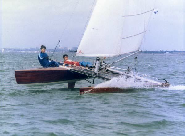

Woodie

I have a soft spot for wood boats. I owned a Cunningham B class Quest years ago and it had wood topsides and decks on glass keelsons. Great boat.
Those wheels are interesting.
