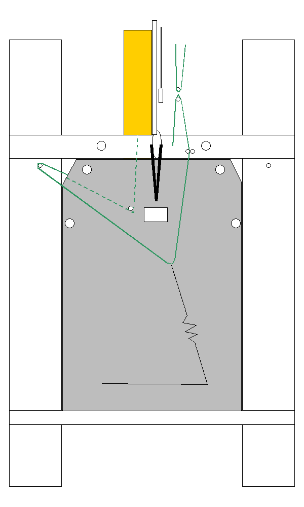

Best setup I used so far, have it on my own boat.
Just stitch a small block to the underside of your trampoline to the rear of the snuffer back.
Above the trampoline run the retrieval line through a Stainless Steel ring (not a block) which is itself attached to a bungee coming from the back corner. Ring is both cheaper and works better.
if more info required then do a search on this forum. I've posted a full explanation about 1 to 2 years ago.
I still don't understand why builder are persevering with very outdated systems that were quickly disgarded as not working.
bump.
I'm gonna give this a try. Also, I keep sitting/stepping on the spin sheets. Will try a similar approach with them.
Thanks Wouter.

i would be worried about getting caught up in the rear tensioning line when tacking etc. Seems like I routinely almost get strangled by the outhaul on the boom or at least snag it and pull it out of the cleat. But then again, I am a tall bastard. I don't live at the back of the boat but I go there to help with the tacks (or that is my story at least). But the set up does seem like it would be nice to face front wheen snuffing... which isn't that hard to do anyway even with the snuffer line going to the back of the tramp like it does on my boat.

Wouter's diagram doesn't show hiking straps. On my boat there are some grommets placed about midway along the straps. I'd like to make use of these and not have the black line run to the rear of the tramp.

I'm using a grommet to put the bungee through as well. Most of the black line is under my trampoline. So there is nothing to snag on, except for the mainsheet and traveller line.
My out is all internal in the boom with a cam cleat on the boom near the mast. So that is out of the way as well.

Wouter, how do you clear your jib track with the spin. tack line? Seems it would interfere the way you have it pictured, unless you have it out on the beam far enough to avoid the jib track.

I think you are talking about the halyard that runs forward to the tack line, rather than the tack line itself, yes?. On my boat the spinlock is located on the main beam and yes it is outboard of the jib track. When I took the photo I posted last week I also took this one in which you can just see the spinlock out beyond the self-tacker support.
