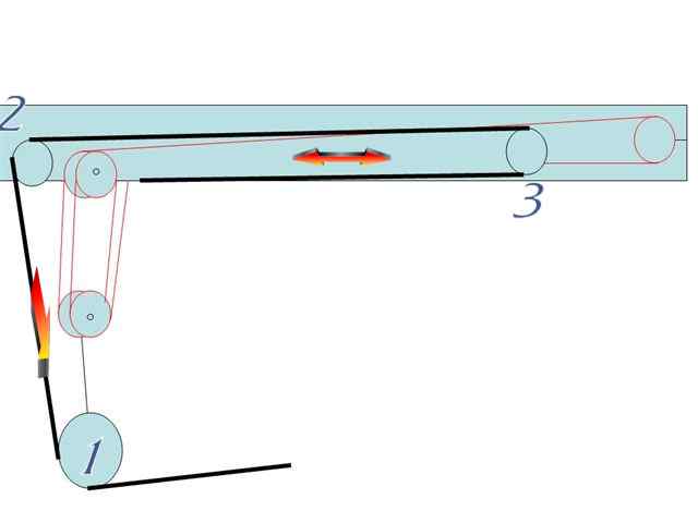

Yes, definitely 9:1.
For anyone who doubts: 1 lb of tension on the sheet (black line) leads to 2lbs of tension on the red lines, which is obviously 9lbs of tension between the boom and main traveller, or 9:1.

I've had another look at this and think thus
Red system is a 4:1.
The black system is a 3:1 as the both blocks (2 and 3) on the boom are (in effect) moving in relation to the back beam.
As you pull the mainsheet in, the first block on the boom(2) is also moving down, as is the big block inside the boom(3), so the black system is a 3:1, making the total system a 12:1.
I cannot see how it can be a 9:1 as the internal cascade is 4:1 and so any multiplier must result in an even number unless there is just a "routing" block, which there are none as all the "big/black" blocks are moving except the back beam block.

Okay, let me explain how it works.
But first lets derive the tension in each line because we'll need that later.
Black line is held in hand and so all the black lines are under 1 unit tension; the pull of the skipper.
The red line is attached to the black line by an 1:2 purchase system so the tension in the red line is 2 units.
It is impossible for any line to have different tensions at different points. Think about this.
When a line makes a full 180 wrap around a block then it pulls 2 times the line tension downward, that is obvious. If a line makes a 90 wrap then the block is pulled down by 1 times the line tension. A termination point equal 1 times the line tension downward. All still pretty straight forward.
Now lets count the loads when looking only at the boom blocks, the others are unimportant.
Black line : about 1 partial wrap so roughly 1 unit down pull and nothing else
red line : 1 full wrap, 1 partial wrap and a termination point ; total = 4 times the line tension of 2 units = 8 units of downward pull
Add them all up and you get (by approximation) 9 units of downward pull for each single unit of pull by the skipper, ergo it is a 1:9 system.
And this is one of the few ways to do it right.

The "count the moving blocks" thing will only work on a standard system of blocks. The key issue here is that the black rope does not come back down to the beam. Instead, it feeds into a second system. If you removed that system and simply anchored it in the boom you'd have a 1:1 system.
I find these things easier to look at in terms of rope moved. What does it take to move the boom 1 unit down? Well, if you remove the final block and imagine yourself sitting on the boom, it's pretty obviously 8 units. Now sit back on the boat and use that final block. How much more rope do you have to pull to shift the boom that 1 unit? 1 unit, so you've pulled 9 units, so it's 9:1.
It's not going to be a multiplier because it's not a cascade. There's only one floating block in the system and that's the one that gives you the 2 x 4 = 8 : 1.

Although my first proposal on 3:1 and 5:1 was found incorrect, I cannot resist commenting on the "Macca-system".
The confusing point here is the 90 degree turn to put blocks inside the boom. If you straighten out the system, you find a 4:1 compund system and a 2:1 cascade. Total = 8:1 (Or 1:8 if you are the boom).
For cascades, you cannot simply count number of line segments.

Nope. If you straighten it out and anchor the "static" turning block (the one originally at the far right) to the boat not the boom (e.g. tie it to a cable from the top of the mast) then you'd be nearly right. In fact, you'd only get 7:1 because the black rope is tied off to the boom not the deck. Fix that and you do finally get to a standard 2 x 4 cascade.
Straightening out the system doesn't change it, and either way you can't get away from the fact that the cascade is anchored in the moving boom, which means you have to move an extra unit of rope.

But I do not understand where "only" an extra 1 comes from.
Here is a simple geometric explanation:
With the sheet taught, lift the boom, pulling the 4:1 blocks 1" further apart. This pulls 4" of the red line into the 4:1 system, moving the floating block 4", and pulling 8" of the black line into the end of the boom. However, since the end of the boom moved 1" away, this pulls 9" of line through the main sheet cleat.
So, it's 9:1, with the "extra 1" coming from the boom movement as you sheet.
Here's another simple geometric explanation:
Imagine you had a conventional 8:1 rigged upside down like this:
BBBBBBBBBBBBBBBBBBBBBBBBBBBBBBBB Boom
/O
/4 4
/ 4 4
4 4
O
and then you take the line at the end and run it through the bottom set of blocks like this:
O
5 4
5 4
O______
Suddenly, it is 9:1. It's no different for the cascaded system. That's where the "extra 1" comes from.
