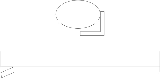

The intention of that particular self tacker is for it to be able to pivot and align itself with the sheet loads. The original Nacra self tacker on the I20 was a molded fiberglass fitting that riveted to the main beam, but because it wasn't able to align itself to the loads it often cracked because of misalignment. In order for that self tacker you have to pivot, all of the pins that hold it to the beam must be in a straight line - otherwise, it will not move once you pin it in place.
I might consider first mounting the self tacker to a straight piece of aluminum angle or tubing and then mount that tubing to the beam...but it would still be tricky. You could cut and bend the ends of the angle to give a mating surface...attach on the bottom on both ends and on the leading face in the middle.

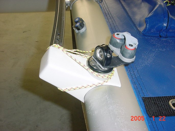

the local tornado guys use an off the shelf ronstan 18ft skiff track for their tackers
Re: self tacker installation [Re: shoom] #89985
11/19/06 05:33 AM
11/19/06 05:33 AM
We have moved on now, but the very first Blade F16's (australia) used a 49-er track as well. All the Blades still use two glass pilons to hold the track. If you design them robust enough then they will hold and not crack. Both pilons are at the end of the curved track. This setup works especially when the track is relatively short. If you use the 49-er track then that rail is of the I-track type and no modification to the track is needed. If you really want to use the much less tall recirculating ball tracks (I dislike them with a passion) then you will have to bend a piece of rectangular Alu tube and fit the track to that. This footing will make the track strong enough to handle the loads when it is only supported at the ends. But I-track is best, simple, cheap and won't jam with sand or dirt.
I think the earlier nacra glass track base was a little to much engineered to low weight. If you have a round beam then a two pilon setup may well be an advantagious one. You do have to align these well with the arc of the jib though.
