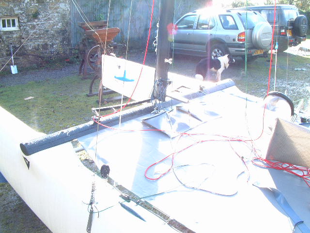

All,
Sorry, no pics with the sails up as we had to rush that bit due to swirling winds one minute and then nothing the next and bucketing rain.
Anyway, did get some pics of the carbon beams and the revised self-tacker. I'll get more pics in 2 weeks (cannot sail next weekend).
Front beam:
Self tacker :
Back beam :
Both beams are Carbon Foam sandwich around the beam bolts with bracing as well, the areas under the self tacker also have bracing. JP can confirm the exact structure.
Overall impression is that the boat is VERY stiff - we picked the boat up at opposite corners and there was very little (if any) sag on the bows - very impressive. I've commented elsewhere on the shape of the kite and to add that the mainsail looks fantastic. Comments on the Jib when it arrives (it will be on the max luff length thanks to the dropped bridals.
Unfortunatly we did not have time to take loads of pictures as the conditions were not kind to us. I'll take loads in 2 weeks time.

I really like what you guys have done with the boat.
Those are really good looking beams and with the eliptical front I think you stand a very good chance on cutting down on spray.
I also like the new dolphinstriker strap. Is that custom to you boat or will this also be fitted to all the new stealths. That strap will make the mainbeam very stiff under mast loads and the flatness of the strap will make it cut through waves effortlessly.
My impression of the Stealth F16's always was that they were rather stiff in the platform, with the upgrades it surely must be very stiff indeed. And that is good as I've seen the new stiffness data on the Blade design.
The competition is definately on.

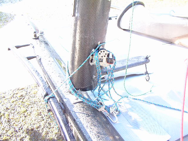

More pictures below, sorry over exposed and I don't have time to photoshop them.
Front beam and Mast spanner - note the rain and sun. It was a very "odd" day

mast rotation comes up from under the tramp.
Then the tails are lead to the side decks thru a small block, then the a cleat
Tail then continues thru the deck tramp eyes - thinking here is that if I pull by the cleat, it somes out, but if I pull behind the fist eye, I pull more roatation out of the mast.
Having looked at the pics, I've set this up wrong as I need the rope to go one more ring back before going down as I will not be able to let off any rotation with the plates up.
