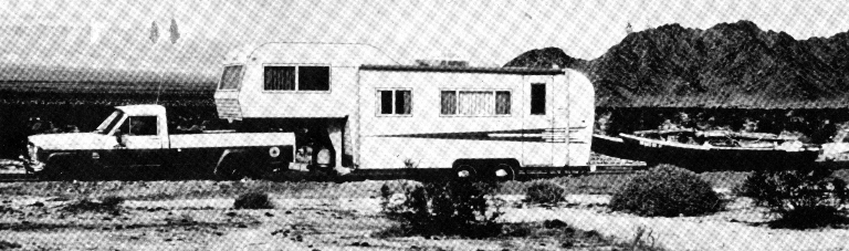

Bob Richards used to have a sweet rack on his pickup for his Seaspray. It extended out over the hood and tilted down for loading/unloading. It also kept the bed area clear so he could pull a fifth-wheel trailer.

As far as double trailering goes, I've only seen it in Calif with a fifth wheel towing a small fishing boat.

Photo attached of the "rig."
