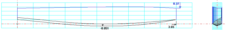

My designs are definately not "tortured ply"
At the moment I can't see how you are doing this then, the two plots you have presented so far seem to show a near vertical bow combined with non vertical side walls. I know you haven't finished yet but I don't yet see how you can have those two features without a small amount of torturing.
A small amount of torturing is not a bad thing it just makes getting the flat patterns more difficult.
I am keen to see how your design progresses, good luck.

I can't see the problem with a small amount of stressing the ply. In fact, I would say it is highly desirable since it induces more stiffness to the design than would otherwise be present plus it looks better! Also, Wouter, I have to agree with Gareth - the sketch you provided indicates some bending of the ply in two directions. I don't see how it could otherwise be made.
The amount of twist is VERY small and developing the shape is very easy indeed. I'm going to make a stiff card model of my second sketch (as amended for Timbo) and see how it works out.

All my designs up till are made with panels that only bend in one direction. All the rest is optical illusion which I'm actually applying to make the hulls look nice !
See here :
Also my bottom panels are significantly more flat then those shown earlier in Johns picture. Afterall I'm trying to achieve some planing properties with this boat. This version has straight sides and a straight bow. The one with the wave-piercer bow is the same but with slightly inward canted sides. The amont of side canting needed for swept back bow is so small that we probably can get that by just twisting the ply inward at the bow.
How or where do you see it ?
Looking at the sketch you provided:
Where the panels join at the bow and along the chine each side, there is undoubtedly twisting of the panel(s). The same could be at the stern but it is difficult to tell from a sketch like this.
The sketch is exacerrated at the stern to show the make up but truly all panels are flat in the real life application with the exception of being bend in one plane.
If you bend two non parrellel panels in their own planes and have them intersect with eachother then the resulting intersection line (the chine) will be curved in two planes. Because this line HAS to lay in both planes ! But each plane itself is still only bend in one plane and therefor not stressed into to compound curve (? right word for it ?)
Do this mind experiement.
Use a flat plat to make yourself a cone. Cut the of at a right angle so the cone is like a round pyramid shape. Now intersect the cone s little below the top with a flat surface. You end up with a circle as a crossectional shape. Now bend this top plate and again make its intersection with the cone. Now the crosssection will be an round but irregular shape. It will not be an ellips although it will appear to be one. No just rotate the top plate. The crossection and chine will be curved and angles in more then one direction but the shape and chine are still the result of only two flat panels bend in only one plane.
My point ? It is extremely hard to tell from chines or crossectional shape whether a shape is made out of the intersection of flat plates bend in only one direction or by stressed plates bend in more then one direction.
