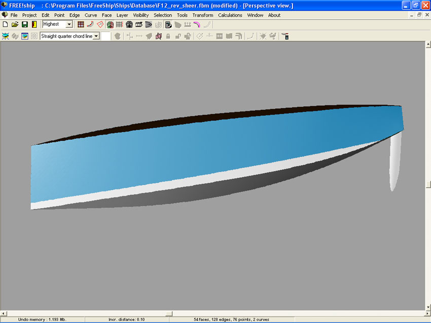

Had an hour or so to play with my design last night. This is the Mk2 version:
