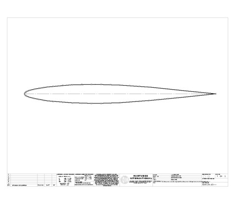

Typically you start with a complicated formula or x&y coordinates to draw the foil. I've got the 63 series setup in a 3-D design table such that I can change any parameter (including the % of thickness). How long and what thickness do you want (10% is pretty standard)? I'll be glad to give you a 1:1 drawing.

here's the 63-010...let me know what format you would like it in too.

Jake that looks great. You are truly a nice guy.
My length is 15 1/2" and max width about 1 1/2" so 10% is fine. I can easily enlarge drawings so a pdf file would suit.

nice guy? nah...just a geek who enjoys this stuff. PDF attached (hopefully). Scale is 1:2

In that case how about NACA 64?

yup, a couple of minutes to plug in the numbers...
again 1:2
