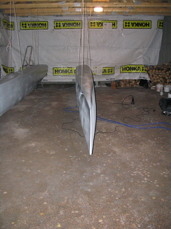

Hi all,
I decided to post here my latest development mainly because I wanted to share my good mood. Recently the hulls started to look like real catamaran hulls (nice feeling, like a proud dad or something <img src="http://www.catsailor.com/forums/images/graemlins/wink.gif" alt="" />). Next I'll start to fair the keel line, luckily I like to play with sand paper. I attached a picture about almost shaped Blade hull.
Sadly the Zandvoort is now out of my reach <img src="http://www.catsailor.com/forums/images/graemlins/frown.gif" alt="" />. I seem to have high over estimates about how many hours I can work in a day. Thus the cat isn't ready yet as it should if I would participate to Global Challenge.
Edit: It seems that I don't know how to make the attachment visible, so you need to point and click <img src="http://www.catsailor.com/forums/images/graemlins/wink.gif" alt="" />.
Valtteri

Here you go:
Coming along nicely I think! <img src="http://www.catsailor.com/forums/images/graemlins/cool.gif" alt="" />

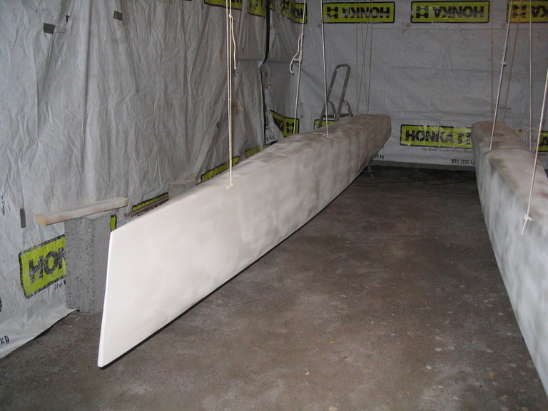

Ok, some new development. The hulls are now mostly faired, only decks are still left. I had some many bumps in the hulls that the fairing took few extra days, but slowly she starts to look like a cat <img src="http://www.catsailor.com/forums/images/graemlins/wink.gif" alt="" />.

I must be worst spray painter in the world or I bought too cheap sprayer. Tomorrow light sanding and some more primer.

The hulls are now coated with polyurethane paint, it was sprayed lot better than the first primer layers. Hopefully she dosn't look as spotty as in pictures after the paint is fully cured <img src="http://www.catsailor.com/forums/images/graemlins/grin.gif" alt="" />. Otherwise I might need to repaint next spring (and this time maybe by a professional <img src="http://www.catsailor.com/forums/images/graemlins/wink.gif" alt="" />).
