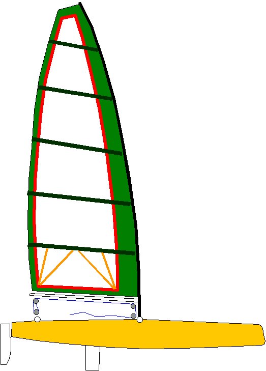

The rudder system looks a lot like the newest boat in the Nacra line (I don't know the name). It is a roto boat with skegs and a similar steering system.
"Funcat" maybe?
Trey

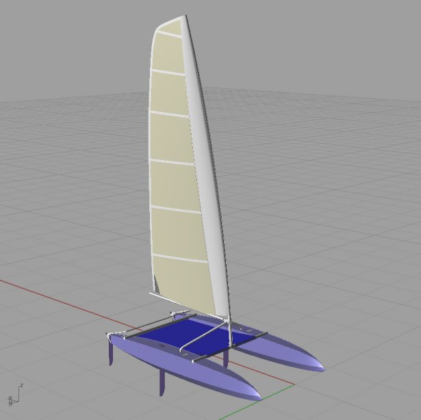

Good points. Most of the safety concerns can be solved with good engineering, like rubrails, righting pole, some reinforcements in the right places, etc.
With respect to the right pole. The design that Phill shows in his artistic impression won't need a righting pole for persons over 40 kg, irrespectibally of the conditions. The latter means that a 40 kg person (or heavier) can right it even in flat water and no wind.
This does assume that Phils design uses a plain alu mast and rig setup as given in this posting :
http://www.catsailor.com/forums/showthre...ge=0#Post124554
I've already run the full body mass and length data on the F12 design that is very similar to Phill design and these are the results. Using the US demographic data, a 12 year old kid (both male and female) weight (on average) 41 kg. Beyond 15 years of age both will weight AT LEAST 40 kg.
A crew of two 8 year olds will also weight at least 40 kg combined; on average two 6 year olds will already put in that weight.
My basic point here is that we should start looking at real scientifically derived numbers and less to what we feel is the case. The scientific numbers show that the Blade 12 (and F12) designs are pretty well suited to these young teenagers and even crews of 2 made up from smaller kids.

I personally think the spade rudders are a mistake. A little bit of heeling will pull the luff rudder out and force all steering on the single leeward rudder that will vent very easily because its area is so close to the surface. But it gets better when the boat puts its bows in a little. Now the leeward rudder is easily lifted clear of the water thus making the boat loose all steering.
Basically each time when you need steerage the most, the boat takes away increasingly large portions of it.
After having done the numbers I found that a 0.500 mtr deep rudder (less then 2 feet) is enough for a boat of this size. I think kids can easily stand in water that is just over 0.500 mtr deep, there is no need to allow the boat to be sailed in water less deep then that. But more importantly you don't want them to sail the boat in deep less deep that that. Again, when they put their bows down they will quickly reach to 0.5 mtr depth. And you don't want them to hit bottom with theur bows during a dive as that will most definately have them pitchpole or capsize violantly.
US demographic data show that kids (both male/female) over 6 years of age are AT LEAST 1.00 meter tall already. Kids of 12 years are already over 1.40 mtr. As such they can stand and survive in water no deeper then 0.75 mtr (6+ years) or 1.00 mtr (21+years). As such I see absolutely no need to NOT have plain rudders that stick only 0.5 mtr below the water surface. This negates the need for any spade rudders.
Indeed they tried this setup (spade rudders protected by the skegs) on the Funboat and the reviews were devasting.

Folks,
I'm not saying this will replace the Optimist.
Everyone see this type of thing differently.
What I will do is explain how I came to this point.
I must apologise if this post is too long. I try to keep them short so as not to take up too
much of other peoples time but in this case thought I should explain how I got to where I am
with this concept.
I presided as Sailing Master and Head of the sailing school at a local sailing club for a number
of years and observed the folowwing when introducing young children to sailing.
In the beginning of my teenier we were using Hobie Hawks as training craft for the beginners.
As far as I can make out they are very similar to the Optimist mentioned, both in size and
sail area.
We would run adds at the beginning of each sailing season and get a very good roll up of prospective
young sailors but would quickly lose most of the students with only a couple staying on for the
season.
Finally my own children were old enough to learn the art so I took them along. It was not long
before I was having problems getting them to go along, I was going to give up when someone
donated a 12 ft windrush Surfcat to the club.
Once my own kids had a sail on the surfcat they were hooked.
As you could imagine this had me quite intrigued. So I discussed the matter with both
of them. They told me the same story. They did not feel safe in the Hobie Hawks because they were so tippy and in addition to this they were slow and boring. Depending on conditions they felt scared or bored.
So we got a couple more Surfcats and as we did we found the kids fighting over them and returning every week provided they got a cat to sail.
Despite popular belief they did not run into each other.
We set courses for the very young beginners in water they could walk. So if they had
any problems they could just walk to shore. Once they felt comfortable they we would
move them out into the centre of the lake and finally into the senior afternoon racing.
Anyhow the result of all this meant I got my sons a cat each.
This created another problem. Every time I went sailing I had to rig 3 cats as they were too small to rig their own.
This is where I came up with the idea of a super fast cat to rig.
When you compare the Specs of the Surfcat to my design they both run the same beam but my design is lighter , has a shorter mast and has less sail area.
The pics posted to date are renderings of a computer model. Florin heard what I was working on and approached me to help where he could . The pictures are a product of his excellent skills in applying rendering to the computer model. He has really brought the concept to life.
Now while from my own experience I believe something like this could make a difference.
There is no universal fix and we each have to do what we can to turn things around until something starts working.
Some things work for some people but we need to find out something that will work for most people.
I'm hoping that my efforts will help in catching those fish that used to get away.

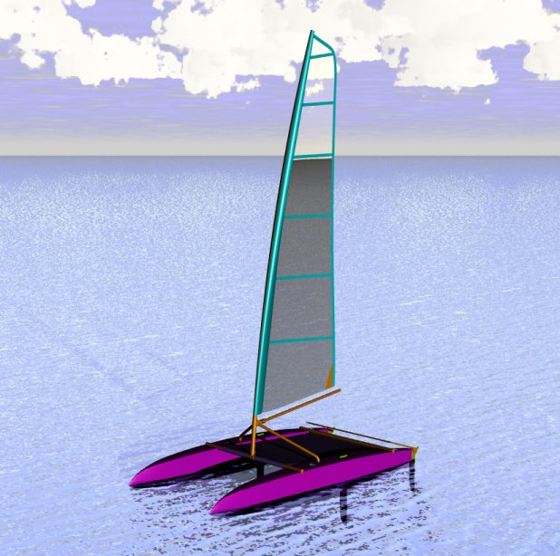

I've placed one of these renderings on my desktop and looking at it again, I'm quite certain...this a brilliant little boat. I want to build one and I don't even have any kids!

Erice,
Florin has made some really cool pics from the computer models.
When my web site is up I'll post all of them along with the pics that show the building process as I move through it.
Once the boat has been prototyped and proven to my satisfaction I'll get pics and video of it sailing, for those who still find the hull building daunting, I'll look at getting the hulls built professionally and shipped pretty much at cost to anyone who wants to build one up.
If we can capture the kids early and get them onto cats it will make me happy.

Won't the tie-bar hit the mainsheet when hard over? Or is it far enough forward of the mainsheet to give enough steerage?
