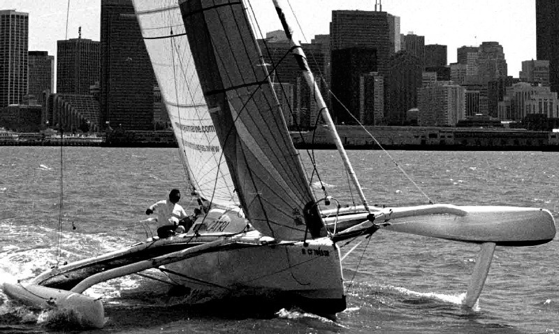

...just move the daggers and add T's to the rudders, which has already been done on the Moths and 18'skiffs. All we need is someone with the time and money to work out the details...
If you mean something like this...
...my test sails will start in a few days. Those "details" are not as simple to work out as it would seem at first sight.
Re: Aerodynamics and lift [Re: Luiz] #127395
01/03/08 01:02 PM
01/03/08 01:02 PM
Posts: 1,200
Vancouver, BC
Tornado Offline
Tornado  Offline
Posts: 1,200
Vancouver, BC
Congrat Luiz!
I know it's been a long, hard struggle!
Get more photos and tell us how she goes...
Mike.
