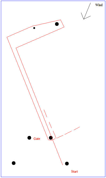

I'm no expert either but this is what we try to do on the Tiger <img src="http://www.catsailor.com/forums/images/graemlins/wink.gif" alt="" />
-Strategy: Before the race or at least some time before the downwind leg think about which side of the course is favorable.
Wind wise, the choices are pretty much limited to left or right and when is the best time to gybe (right after A-mark or nearer to the layline).
Usually if for example the left side is favorable going upwind than that side will also be downwind (<- Does that make any sense?).
Obviously current can also be a factor (closer to shore for less more offshore for more).
-Tactics: Try to keep clean air. Make sure others are not going over the top of you, and try to cover others.
Dont get stuck in dirty air, gybe away if necessary.
Keep an eye on VMG, don't point higher than you have to and move your crew/butt around to fly a little hull when possible.
When approaching the downwind gate think early about which side you want to round it so you hold the best cards for going upwind again.
(Hopefully other will correct me if i'm wrong but I hope this helps).
Well, a dumb blonde like me might think "that side" means the same side of the course will be favored both upwind and downwind.
Actually, if the left side of the course is favored as you are looking upwind, the left side of the course will be favored when you are looking downwind, which means you would head toward the side of the course OPPOSITE that which was favored on the upwind leg.
Probably not much more clear? <img src="http://www.catsailor.com/forums/images/graemlins/tongue.gif" alt="" />

Explaining stuff was never my strongest point <img src="http://www.catsailor.com/forums/images/graemlins/blush.gif" alt="" />
But I guess you are right, maybe its just a different way of looking at things?
Maybe a better explanation would be that when going upwind one tack gives better VMG, and downwind the opposite tack.
So if upwind starboard is better then downwind port is better.
Is this any clearer?

Hmmm. Your diagram has you going upwind on the left side of the course and going downwind on the same side of the course. If the left side was favored upwind, the left side is favored downwind, so you want to go downwind on the OPPOSITE side of the course from what you were on going upwind.
So it is not helpful to explain it according to what tack you are on. It is a matter of what side of the course you want to be on for the most favorable wind shift.
If the reason you are on the same side of the course both upwind and downwind is because there is more wind over there, then your scenario is correct. But in that kind of situation you would say that if the left side is favored upwind, the right side is favored downwind.
Sorry, but I tend to think in terms of which way the wind is shifting to decide which side is favored. If the wind is going right, you go right. If the wind is going left, you go left. And "right and left" are based upon whether you are facing upwind or downwind. The upwind's left is the downwind's right.
