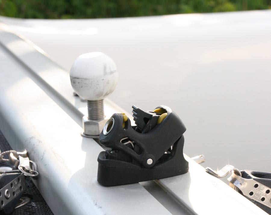

Here is another way to do the same thing, but with a spinlock.

I've got a spinlock for the halyard, I'm always accidentaly re-cleating it when dousing.

If you try a little bungee cord from the swivel cam cleat to the spin turnning block it will pull the swivel cleat side ways some when you pop the spin halyard to drop the shute.
The halyard will drop next to the swivel cleat and not attempt to recleat it self.
At least on my boat it works well.

Mike that's a good idea. My fleet's regatta is this weekend, I think I'm going to use the stock cam cleat and your idea this weekend. It's sitting there doing nothing anyway.
