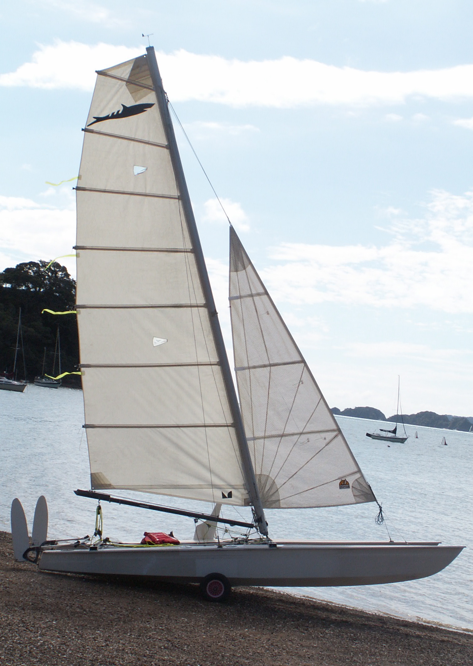

I have posted info about my attempts to create planing speed with my Tiger Shark.
I continue with that plan but have some questions about why the short sloop rig would run well up and down wind instead of just across it.
I have cut 6 feet of the mast and square topped the sail. These are rough old sails re-cut.
I went out with this boat against a good sailor on my very tidy H17 running a brand new pentax square top.
I beat the Hobie in varying conditions up, down and across the wind. The only time the Hobie had legs on me was in variable 5 knots up wind into rough chop and a 5 foot swell.
I was astonished to beat the Hobie up wind in ten knots with all that power up top against my sawn of shotgun mast, although I understand that the rake on the TS would help.
I was also astonished to beat it down wind because of that same rake and short mast.
I am asking if any other cat than the Hobie 16 is raking mast for a perceived power gain? If you know of one can you post a photo? Thanks

Let's start with basics-
Power to weight is the big game in cats if rigs are comparable. Isn't the Tiger Shark quite a bit lighter than the H17? Is the sq main on the H17 making up for the heavier platform?
Yes, the logic I have played with the T.S. is a light two man boat with less sail area managed by one person will be faster than the original two man version.
But the H17 is a good up wind boat and the sail area and height on the H17 dwarfs the T.S. so I am still surprised.

until you swap drivers so you are on the h17 and he is on the TC, i don't think it is telling you much
there is generally fare more variance in helming abilities than there is boat limits
Fair comment. All I can say is the guy sailing against me has raced cats a lot more than me in competition and we sailed boat to boat for four hours. The H17 is an idiot proof boat to sail, very much set, point and shoot. He should have had more than one five minute sloppy beat in which he was quicker. But, fair comment.

115Kg??
That is only 254 lbs. If that is accurate that is a sizeable difference over the 340lb (prolly a bit more) H17.
And what is the current sail area, main + jib?

I was shocked to be told the weight but I can feel no difference between pushing this around the beach and my Taipan 4.9 which is 105 kgs. on the same beach trolly. NZ foam core race boat. H17 is a little over a quarter heavier at 155 kgs and on the same trolly is a different category entirely!.
I will do the sail area when the new ones arrive.
Now a question for all, especially Rick if you read this. I have just hauled the new reacher up the mast and at mast head it wants a prod out the 1.400 mm from the bows. Is this too far. I was thinking more like a meter. Should I just suck the sweetie and see and cut it down if it does not work?
