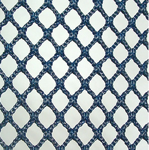

Take a look here for knotless dyneema nets that need no reinforcement in the edges and are the lighter, stronger and simpler thing you will find.
Luiz

aside from sunrise (multihullnets.com) anyone know where to find this netting or something similar? Holes need to be 3/8inch or so
This seems to be (blue) coated knotless polyester, almost the same as the dyneema version. I believe you can find it in the same place, Net Systems, Seattle.
Luiz
We use some of that on our machinery we build...that weave and pattern in polyester is equivalent to 20 grit sandpaper. It's VERY rough. It's also very "springy" and would be difficult to get it reasonably tight for a trampoline application.
It is for the 31 and I don't keep them very tight- you have to loosen them to fold the boat up anyway then re-tighten them. kind of painful if you do it with any sort or regularity.

I have that stuff fwd of the main beam on Flight Risk, it allow me to be up there, but even tensioned very tightly it'll sag a good 12" when I'm on it(I'm 160 lbs). And it is abrasive, and uncomfortable to lie on. It's hard to imagine liking it as a trampoline.
