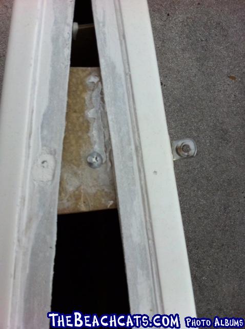

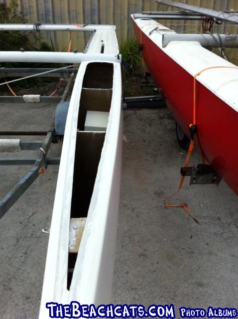

btw - this is what Im trying to accomplish (this was a friends mystere a few years ago)
[img]http://www.thebeachcats.com/gallery...p;g2_itemId=123588&g2_serialNumber=3[/img]
[img]http://www.thebeachcats.com/gallery...p;g2_itemId=123589&g2_serialNumber=3[/img]

I THINK west systems G/flex will be the sealant of choice but I will have to check with Catman for input. He has successfully removed and re-attached several Mystere decks at his shop over the past few years. My pics above are from a friends mystere at his shop
