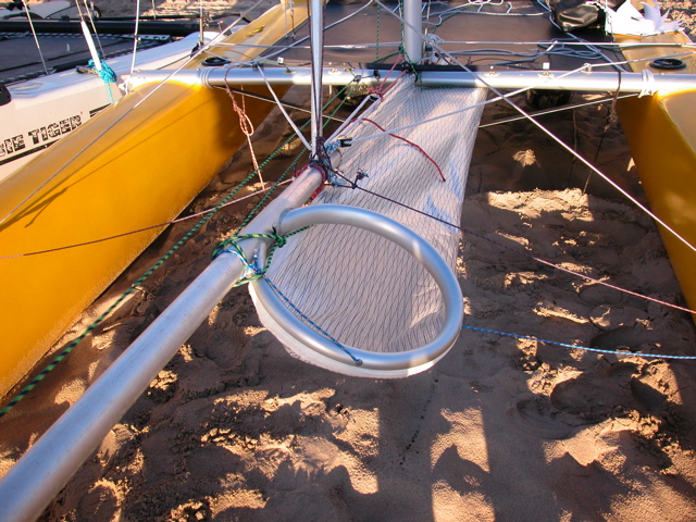

What is that ... [Re: CaptainKirt] #44149
02/12/05 06:14 PM
02/12/05 06:14 PM
What is that arm (lever) on the upper mastfoot. Mast spanner ?
And here you see it fitted to my boat ! [Re: Wouter] #44150
02/12/05 06:23 PM
02/12/05 06:23 PM
Only I had the white cloth bag instead of the grey one. I like the grey colour better. I never realized that there was a choice.
Don't mind the different lines that is all much tidier now
44545-KODAK 209_40%.JPG (40 downloads)

A few answers [Re: CaptainKirt] #44154
02/13/05 12:18 AM
02/13/05 12:18 AM
What is the diameter, wall thickness and length of your "strut" to the spi pole?
I will have to get back to you on that. Give me a little time.
Also, do you know where the front most small line from the snuffer ring is supposed to go?? I noticed you just have your's tied around the pole!
yeah that picture was taken right after the DCC and we had to quick fix a few things.
Actually in a few special cases the spi cloth was reported to catch in the V between the pole and ring. I have never encountered this problem, but I always fully tension the retrieval line before uncleating the halyard. My spi is as good as tube before it enters the mouth and I don't think it can hang that way.
But the line is a remedie for the spi hanging up like that. You rivet a small saddle under you pole at about a foot ahead of the ring and you tie that line of to that. Now you have a little triangle between the line the pole and ring. Therefor the line prevents the spi from going into the V between the ring and pole. That is is.
But at the DCC the tying off the line to the pole as showed didn't cause any problems.
