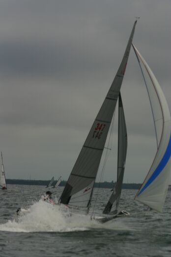

yeah well...you should also add that we DID have the spinnaker up at the time but we stuffed so hard into the back of a wave that we put the bottom of the spinnaker under water which lead to the broken pole and shredded spinnaker.

we kept her flying after this...we were the last to be flying a spinnaker (never took it down for the sleigh ride).

Yeah, Jake, but that`s not a proper "Pelican", I can still see your snuffer chute !
See attached pic, courtesy of the Spitfire web-site. Now THEY know how to do the Pelican..

Dont know about the pelican, but they are definately deep sea fishing! Wonder if they saved it?
Re: Don't do "The Pelican" with your snuffer! [Re: Rolf_Nilsen] #47358
06/09/05 03:56 PM
06/09/05 03:56 PM
Having sailed a Spitfire, I would say most likley they did !
Re: Don't do "The Pelican" with your snuffer! [Re: scooby_simon] #47359
06/10/05 08:30 AM
06/10/05 08:30 AM
Well, that's amazing. I have heard about wave piercing, but that Spitfire looks like they have taken it a bit to far
Re: Don't do "The Pelican" with your snuffer! [Re: Rolf_Nilsen] #47360
06/10/05 09:23 AM
06/10/05 09:23 AM
Indeed, My opinion in all these is that if both crew stay put you can get most things back - I had my Hurricane deeper than that and it came back - we had water up to the first batten on the mainsail !
