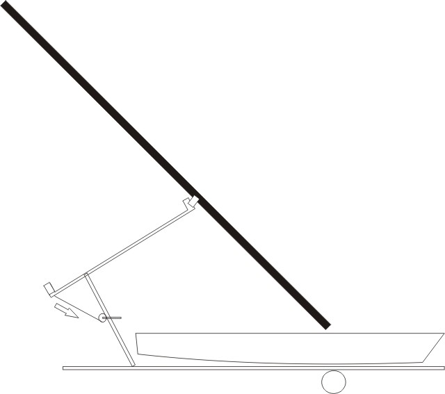

Alright, here's a basic drawing of what I'm talking about. This thing raises and holds the mast so all you have to do is push it foward a few feet.
Take down is just the reverse. And........
after the mast is up you can disconnect the winch and attach some shock cord and use it to chuck pumpkins at passing boats.
I'll still post the PIC in a couple days.

Nice idea on the mast rasing....
If you angle your lever up at the hinge you would get more lift and might even get the mast to nearly vertical. Or you can add a 90 deg arm to the end (at the top of the mast) or both...
I always tie my trap handles to a rope I keep tucked inside the main beam - this way the mast can only move in one plane, so if a gust hits the mast, you wont be fighting it to keep it stable.

My proportions are way off in the drawing. The chock at the end of the lever was large to keep the mast from falling off to the side when up. Also the lever was the front mast caddie for trailing. Both ends of the lever were padded.

Howard, I guess the point here is the need to simply and safely raise-lower the mast no matter the boat. I'm sure it would help open our world to more people.
The one thing about the H-16 when raising it by yourself is the trap wire shock cords. Since they are free to float around under the tramp they wind up at the back as you start to raise. So not only are you raising the mast weight you wind up having to deal with the shock cord trying to pull it back down. Plus they tend to get caught on stuff.
So before you start, get something to hold the shock cords around or in front of the shrouds.
Again, my drawing is not accurate. The base strut was more vertical. So when it was cranked up the whole thing was almost straight up.
Jake I'm not sure if that would work as easy. I think yours lifting closer to the base would have more load on it and the chock would have to slide a greater distance on the mast and pivot to maintain side control of the mast. Also the spreaders might get in the way as the chock slides up the mast. Looks like it will chuck pumpkins though.
I'm a big believer in towing the boat backwards. For those removing your rudders anyway then why not? It's just easier to raise the mast. I know some people are afraid they'll drop it on their car. With this system that problem is almost eliminated.

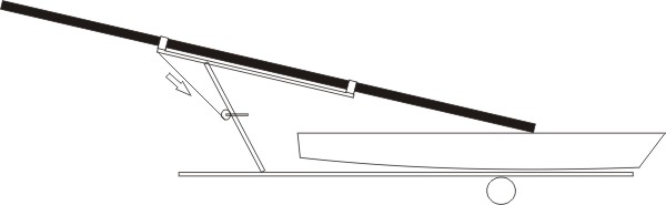

Jake,
Somehow, my simple brain is not grasping how the drawings in previous posts are going to lift the mast. It seems to me they are just going to pull the mast lower. How is the lift created? I see the directional arrow showing which way the line goes, but it seems to just tighten the mast down.

Rob, give me a few minutes and I'll post a drawing of the mast being held up.

Here it is.

South Florida
Jake, that doesn't look like it would work. The winch end seems so short compared to the mast end, and the mast end being so close to the base seems like it would be a huge amount of weight to push up. I think 2" tubing would bend pretty soon. Plus it you go past the point shown on your diagram the mast would start dropping again. I know my Hobie 18 mast would not go up this way. It seems like you would need more leverage on the pulling end and more thickness on the pushing end.

Actually, if the strap could go over a roller on the short end, then over an extension of the mast support in the center and then attach to the mast end, so that the strap is pulling up on the tube (like cranes) then I could see it being supported much better.

Jake, I think there would be a large difference on the mast base. Yours is trying to lift the mast off the base before the mast raises. The other system is more like lifting the mast from the top.
Ok, Ok, Ok....but if you look at it, the position of the mast brace is no different than if you were standing on the trampoline raising the mast manually - and the mast wants to come off the ball then too but the pin retains it. You guys just keep telling me it can't be done and I'll actually have to build one!

I agree with Jake. If the bottom "brace" is in fact a roller it will work. As soon as you start winching, the fulcrum becomes that bottom roller. As that fulcrum becomes higher and higher on the mast, the lever (mast) has nowhere to go but up!

I see that this system could raise the mast up to 45 degrees or so, but not much farther. My question is why would you bother with this setup, when a gin pole would be much quicker and bring the mast all the way up? Just turning the boat around on a trailer would be more work than raising the mast by hand.
For those who raise the mast by hand, that's fine, but I've found added safety for me and my wife by having more control of the process when using the EZ-Step.

Jack, keep in mind my boat is towed backwards so there no added turning it around.
I should have the disc with PIC of the working model tomorrow.
Howard your right, some people have strange ideas how to get things done and the guy you mention should be up for a Rube Goldberg award.
Jake, keeping in mind they both lift the mast to about the same height, I still think the other one will work better. I might spend some time messing around with both ideas. I have a friend who's quite the fabricator and I'll talk him about making a couple mock ups and have a closer look.

David your right and that was another point I wanted to make after looking at Jack's set up. I don't think your going to let the small contact point of a roller pressure the side of your mast. With the other system you could use a contoured pad on the end of the lever. It would work with the mast 90'.
The boat I saw this system on was a G-cat 5.7 and that mast has spreaders.

It's not my contraption. Just something I saw on the beach. However I think you can guesstamate the lengths. The best way might be to pin your mast and determine the lenght from the back of the boat to you spreaders as the chock would need to start below them. You also have to account for clearance at the back of the boat so the arm would be able to swing down without anything in the way.
Remember this thing gets it about half way up. It doesen't put it all the way up. Half isn't bad though. And the last and most important thing is the boat is backwards on the trailer.
I believe the G cat's mast is raised at 90' also. It would most likely stay that way easier (larger flat surface). Of course if you make the chock a little wider and flat it should want to lay at 90.
One other thing about it is the plate's that make up the piviot. Notice it prevents side motion at all points, down,up and on the way up. Very important!
I've seen this rig only once. If he comes out again I'll talk with him about it. Don't hold you breath though.

I think the best bet is to look at a standard camera tripod. One way to make this would be to cut out a circular piece of plywood and use a pair of angle brackets and a bolt to make a hinge point for each leg. You can then attach a V-shaped mast cradle to the top. Yes, you do need some sort of keeper strings. If the top is too wobbly, you may also need a vertical rod of some sort down the middle attached via keeper strings to each leg. Standard tripods usually use folding bars of some sort for this, but strings will do the job as long as you spread the legs until the strings are taut.

Greg,
I forgot what kind of boat you have, but if I remember correctly it's a Narca. So, what I do may not work exactly for you, but I think it wil help steer you in a more simple direction.
My fore mast support on my trailer is 60" high and mounts to the trailer tounge. I have a Trailex so I ordered the long mast support. I did this initially so I could car top my kayaks and bikes while towing the boat using it for a mast stepping system was a bonus. Anyway, at the top of the mast support, mount a sheave (an old winch drum works great) and mount teh boat winch below it at a convenient height. If you are tall, you can mount the winch up high, but it doesn't work well for dragging the boat onto the trailer that high. Basically, you want the sheave at least 24" above the mast step so it is effective. The higher the better. If I am alone, I use a step ladder to support the top of my mast. The ladder fits nicely under the boat on the trailer. If I have someone with me one of us holds the mast above our heads while the other cranks it up. I use a set of trap wire to steady the mast when it is at a low angle. I tie the off to the front cross bar. After about 45 deg the shrouds can take over.
I try to keep it a simple as possible and use components that can be used for other things as well (like a winch to step the mast and drag the boat onto the trailer).
I have seen lots of fancy systems to step masts out there. Most are too complex and too $$$ to be worthwhile.
I hope this helped somewhat.
Nick
