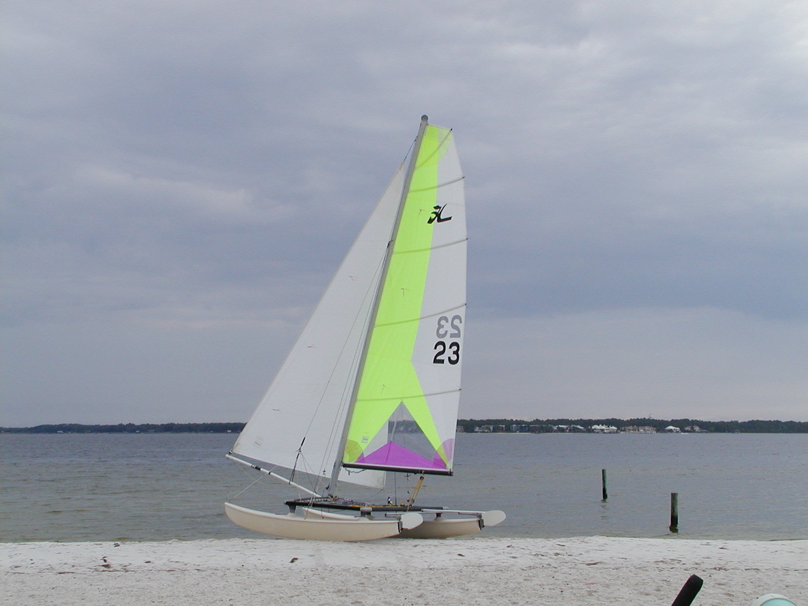

I have a Hobie 14, which I have not used in 3 years.
Every Year, around my Birthday, I get the bug to want to put it back together. It’s that time again. I know what she needs to be usable again, but I would also like to breath new life into her. The F-14’s sound super and the maxi H14’s I’ve seen are hot. The boat has a factory Dolphin Striker and the jib sheets on the tramp. Someone please send me a high res photo of a maxi H14 or a description of what and how to put it all together. I am going to the Flee market at Dolphin Stadium this weekend and hope to be able to pick up everything I need there. Thanks..

I'll get some pictures at Spring fever, so It will be a few weeks before I can show you. The hardest thing to find is the spin pole if you want a used one. Try getting a "Skinny" brand windsurfer mast, or at least a newer thinner style. It is important to get the plastic base so you have some kind of backing for the pole against the front beam.
If you can get some Oxen blocks, get them. Other than that, you will probably have to make all the rigging. It is a pretty easy conversion!!
If you want a Hooter sail, I have one that I would sell.

Here are some photos of Bob Curry's Turbo. The boat itself was nothing special and the hooter rig looked like is was made of old PVC and duct tape. However, he kicked our butts. In my opinion, the mainsail was the real "Turbo". Sure, the headsail rocked off the wind but the main was driving all the time and Bob made it point high and go fast. But then Bob's no slouch, eh?
71338-Hobie 14 MAXI1.jpg (384 downloads)
