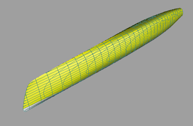

For anyone who might be interested in my idea of an extreme F16, this is it:
Striker screen grab
I've christened it "Striker". Well, you've got to find something to do rather than work, haven't you?

Are those images at scale? What program is that? I think I can use that to design and create scaled graphics.

That's the Freeship program that Erez posted the link to earlier. Yes, they are to scale.

It looks like a "Striker" to me!
but it needs more volume up front
How long did it take you to do?

I did say it was extreme.... I have actually put quite a bit of volume up front, especially low down. I guess it took a bit over an hour to knock up.

"Striker"? Looks more like a "Sniper" to me <img src="http://www.catsailor.com/forums/images/graemlins/smile.gif" alt="" />
How would you build it?

It'd have to be built in carbon/kevlar/epoxy because of all the compound curves. So that means building a plug, and a mould and a vacuum system so it's not a realistic home DIY project. Anyhow, it's only my idea of the ultimate, 'edgy' F16 hull shape. The hydrostatics actually look pretty good but I think it'd be really difficult to sail and the crew weight and position would be hyper-critical.

There is some software available to analyze hull performance. When toying around with ideas, it can be a fun exercise to run your hullshapes trough it. A hull canted outwards should be inferior when sailing the boat flat.
http://www.cyberiad.net/michlet.htm
Here is an example of how the software can be used:
http://personal.inet.fi/private/muu/torodrag.htm

And what is really good about this program, (besides the fact that it is specifically for long thin catamaran like hulls) is that freeship can output the data directly to it, so if John can post his hull file somehow, I am happy to run it through michlet for you.
But as Wouter said unless you have a spec, i.e. something to aim for the results won't mean much.
