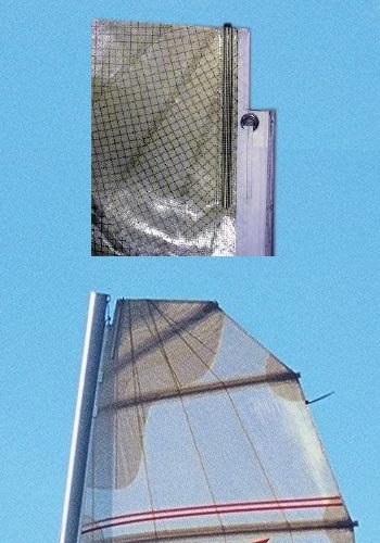

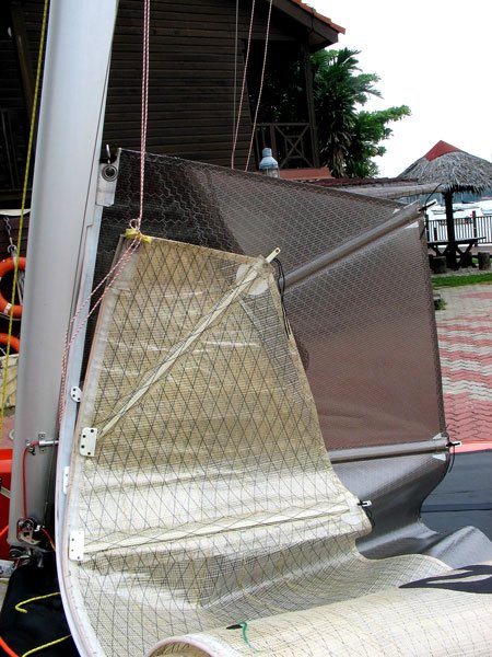

Maybe there is an advantage of having the top of the sail run level with the top of the mast. Too bad that this same feature can be had with a halyard system as well. Some F16's already have such a setup, see the pictures for clearification.
So the question becomes, is there any real advantage of having a push up mainsail ?
