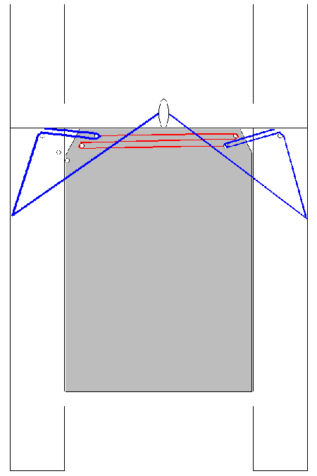

Actually one of the reasons I run the jib sheet as shown in the previous drawing is to keep it well clear of the other control lines on board.
I run my downhaul like this :
The red lines are underneath my trampoline; the red line is a bunchy cord.

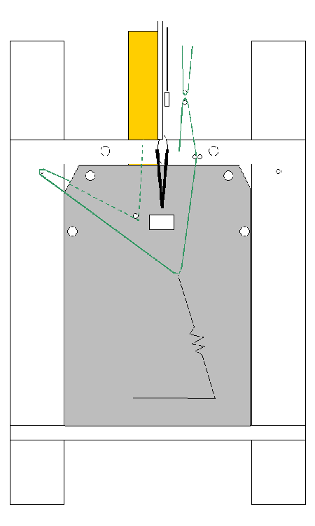

I run my spi halyard like this :
The dotted green line is underneath my trampoline. That black line is again a bungee cord.
If you superposition the three drawings then you see that all lines are clear of eachother and that nearly always the are run at an angle to eachother. This prevents the lines getting wrapped on eachother. All lines are tensioned by a mild force and al the control are accessible and operatable from everywhere on the trampoline by both a doublehanded crew and a singlehanded crew. The last is important to me as I do sail/race regulary solo as a cat-rig + spi or a sloop rig. I still race most often as a doublehander.
