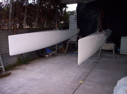

My paint fella showed up and painted the twins today, reasonably happy with the result, will have to let it sit for a couple of days to cure properly, which isn't goin to be easy for me not to do anything to it. Must show self control.

It is looking good.

I agree it looks great.
It proves that patience in the preperation pays off.
I will try to remember that.

I'm not sure what the next step is, wet n dry (very fine) or just cut and polish or both? I guess I should wait til the weekend before trying anything though.
Any suggestions would be well recieved.

What type of paint and base coats did you use? Did you apply clear coats and if so, how many?

Matt,
If polyurethane it takes a bit of work to fine rub as it is very hard. But if you do you will see anything corser than 2,000 grit in the gloss. If really pushed you could do
1,000 as the scratches left are not too bad.
600 is easier but you pay fot it in drop in quality of the finish.
Takes about 16 hous to wet rub.
4 hours per side per hull in 2,000 grit.
I'd still buff with light cutting compound or polish with alight cut in it.
Stay away from the gunwales with both or you'll go through the paint quick smart.
Hope it helps.

Yep very happy with it.
As per Phills suggestion some time ago, (when I thought I was ready to paint) I have used Dulux Luxepoxy 4 White Primer in the end probably 3 coats with lots of wet sanding and Dulux Luxathane White, paint man tells me 4 coats, I wasn't really expecting that much but its come up pretty good, and he hadn't painted a boat before, so wasn't to know.
No clear coats I don't think its necessary, I think I'll leave it as is for the while, and see what happens over the next 6 months as to what course of action to take.
