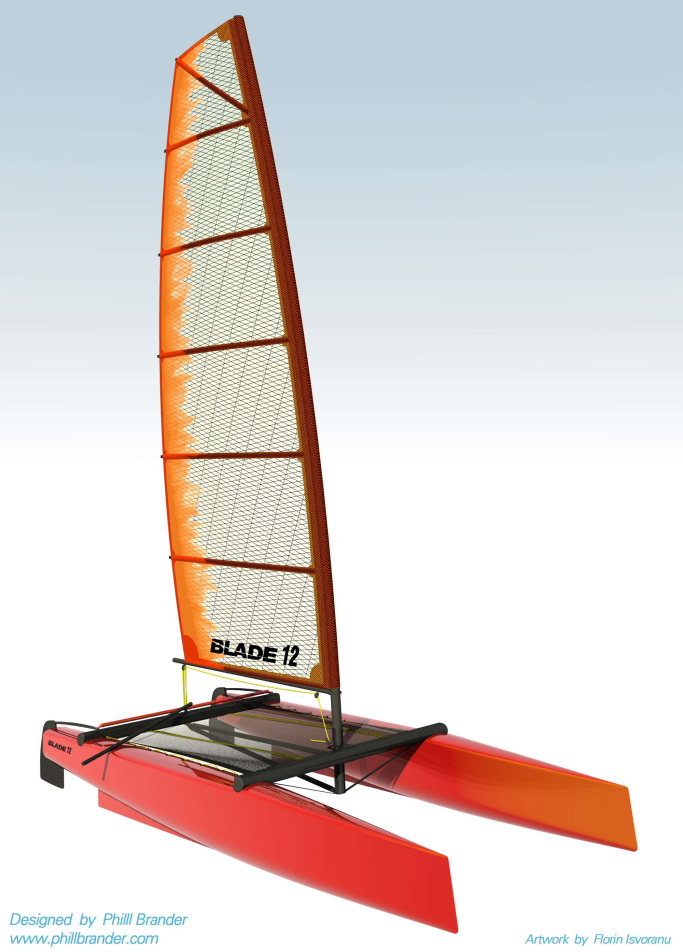

Folks,
Since posting some renderings of the computer model of a design I'm working on in a thread called
"This one is for the Kids".I've had various comments and suggestions.
While this is still being developed it would be handy to get some input from parents on a couple of
possibilities regarding the configuration of a Cat for kids under the age of 12.
There are 3 possible configurations being considered and the input I'd like is related to these configurations
when considering the corresponding costs of each.
1) Spade rudders and Skegs
2) Deep Rudders and Skegs =1) + $700 to $1000 (estimated additional production cost)
3) Deep rudders and Centre Boards = 2) + $1000 (estimated additional production cost)
Points to note:-
I will test all configurations to quantify performance differences.
Home builders would not incurr cost as high as these but will pay in the form of building time.
Interested in Comments.

I vote for number 3 as a grand parent who trained my 14 yr. old grand daughter on my H-17, since she was 6 or 7, wish I would of had this then. Will consider this if 8 yr. old twins come to Fla. It should give the kids the feel almost of an A cat and get them ready for the newer boats with boards when they are big enough to move on (like your Blade F-16). GREAT design, keep up the good work.
Just my 2 cents from 27 years out there.

John Williams had a timely post about dagger boards today.
I think you are asking way to much from the under 12 crowd to operate boards and to much from the run of the mill home builder to build a hull with a well.
The rudder lock down needs to work very easy and not require much strength.
Phil: The designs are great. I continue to wonder in the microwave world of the USA how many people will take on such a project.
My vote would be # 2
Pat Bisesi Fleet 204

Pat,
The Opti is still the biggest kids training boat out there and they have no issue with having board as does every other mono-hull typically used to move up from there.
That being said I agree it is more work and or cost and of questionable performance gain for kids at the level this is being designed for.
High aspect rudders however do have a considerably different feel and I feel would be worth having.
My preference fo my kids boat would be #2 as well.
Matt

Phil,
Preferably the boat should be simpler to rig than an Optimist or Laser.
Would it be possible to fix one daggerboard cassete in the central truss?
From the 3 available options, my vote goes to #2 (but the spade rudders should be dagger-rudders like those of the 29er).
Luiz

Phill,
I have several kids, so I can speak with some experience here on what I'd like. The design looks absolutely stunning. In fact, I'll take two asap. As a parent, here's what I'd like to see:
--boat weight about 150lbs so a 12 year old could move it around on beach wheels
--high aspect rudders but skeg keel (spade rudders spin out too easily when flying a hull)
--car toppable
--minimize fittings with loosable parts (eg shackle pins)
--if there will not be a trapeze, an unstayed rig would be great too; put the mast in the hole and go.

The feel of the helm with deep rudders is very important. The added performance/cost of the daggers isn't justified at this level.
#2.

As someone mentioned before, if the rudders were VERY easy to lock down, I like version 2. I have kids and the centerboard, while great for performance and handling, is too much for a younger sailor (hell, it's too much for many older sailors) and would eventually lead to a grounding and damage. The centerboard in an opti is easier because the boat is slower and there is only one. I think what makes a boat fun for kids - particularly those who are beginner to intermediate in skill - is forgiving handling. If it easily gets trapped irons or is quickly overpowered, I think many kids will be frustrated or scared away. That's the beauty of the Opti, or Hobie Wave, or Laser Radial.

I think design number 2 is right on the money. The skegs are the way to go, provided that they are durable.
What kind of surface area are we looking at on the sail?
Having started off at that age with a sunfish, I think rigging more like a sunfish would make it more easier for a 10-12 year old.
Perhaps something with "reef points" on the sail? Then parents would have the option of powering the boat down for smaller kids.

Seems be #2 is getting the vote. I have skeg keels on the Mystere 4.3 and they work GREAT. I can point good and have no problem catching most of the boats till they put there chute up. Remember one time catching a Hobie 16 that was WAY ahead of me and passing him.

Jake:
Spade rudders will be to short. THINK about what happens when of your rudders kicks up while sailing now? EVEN on my little 4.3, which at 240 lbs is 160 lbs or so lighter than your I-20, I get weather helm like hell with it up, even though some is still in the water. PLUS vibration and wind flapping from trailer speed would beat them to death. I am constantly advising newbie to take there damm rudders off and put them in box or car. Friend has his run into with rudders on and wiped them out.
Just my 2 cents,

Phill, as I said before, if your intention is to put out plans for home builders, why not simply offer the three options? This would support a developing level of competition amongst builders and sailors which might make the whole catamaran learning process more demonstrative, encompassing, extensive and complete, thus better preparing them for their future in catamaran sailing/racing.
The Sabot has a daggerboard and a blade rudder.
I also like the center fin case for a single fin which could be a fourth option, covering all the bases.

My vote goes for the N°3.
In Switzerland we have very little winds and a cat without boards may not get well accepted. IMO, in lower winds the cat without boards will not go good enough against the wind.
All monohull dinghys have boards, so it can't be of a big problem. It helps the kiddies to right there cats too. Otherwise maybe a pivoting centerboards might be a solution too.
