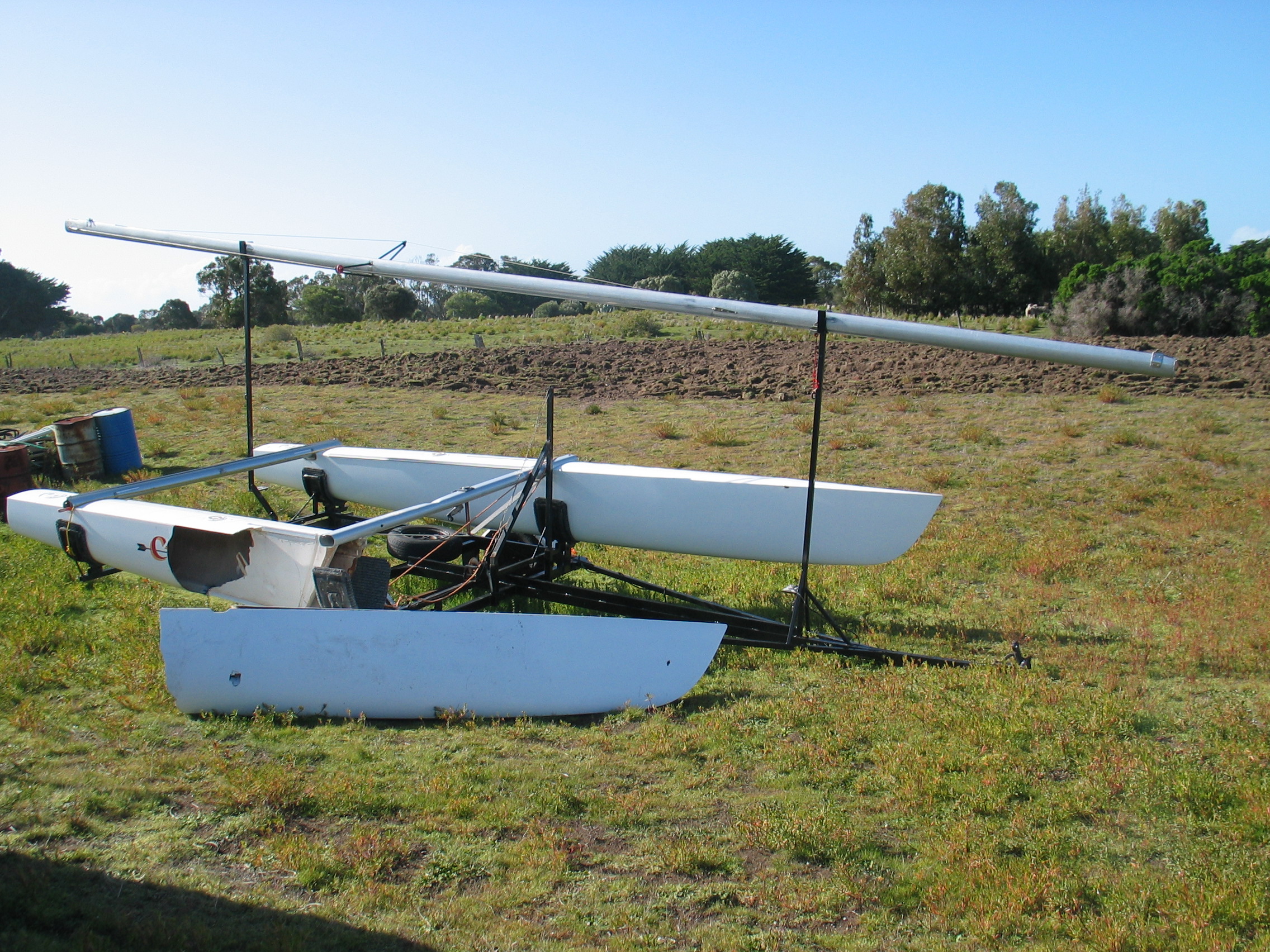

If you have the old tapered mast you may need to consider a newer mast to suit the square top sail. I'm far from an expert but have attatched the photo of the only Tornado I've ever owned. Wont describe what happened. If you were closer I'd have a stack of bits for you

It's a classic.. Looks like it ripped apart at the shroud fitting? Hope you either fill in with the story here, or make a new thread, even if you said you would not.
regards
Ohhhh....you can't just drop that bombshell and not explain it. Looks like a trailering accident to me.

My money is on a big storm cartwheel because it was not tied down well enough.
it does remind me of the guy with a Hobie 18 that though he could tow it home with the mast still up! He hitched it up behind his Dodge Ram and went gunning off towards the overhead lines across the road. The result was both bows snapped off at the front beam [try doing that to a TheMightyHobie18] and no telephones in the neighbourhood for a while!

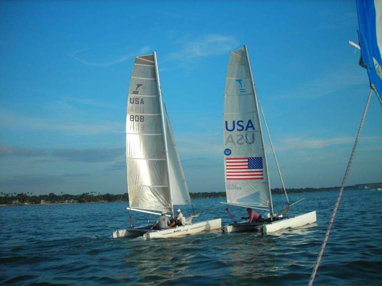

Dunedin Causeway folks have done a lot of used Tornado sails on Mysteres as well as GCats . We are blessed with Robbie Daniel in town and he often has used T sails, both old pinheads and newer squaretops. The Mystere mast is the same as the old Sailcraft Tornado extrusion and the Tornado sails work great on our boats. Here is a M6.0 and a M5.5. Note the 5.5 had the head recut to shorten about 12 inches. Write to Jill Nickerson for sail info at funinthesun(at)juno.com
