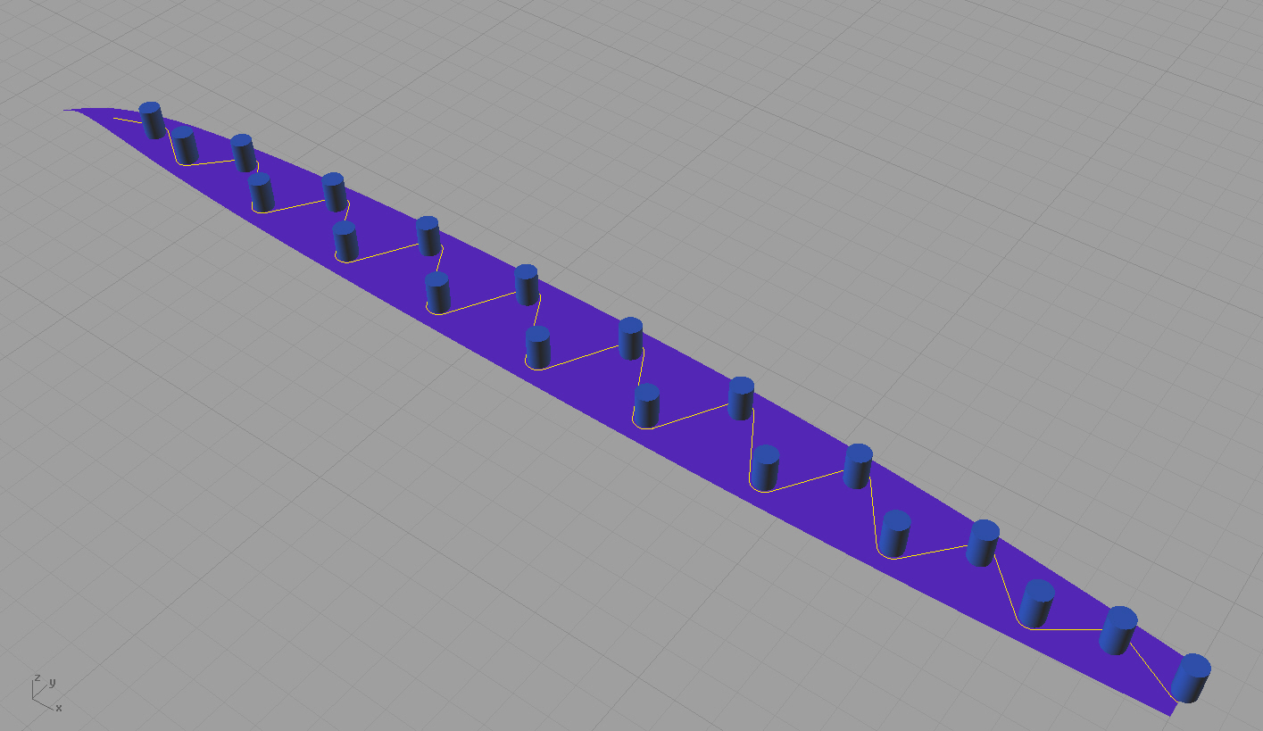

Pic 5 Now lace the carbon uni around the cans as shown and wet out with resin. Just before it gets totally hard, run around the intersection of the cans and the uni with a boxcutter and then remove the cans
